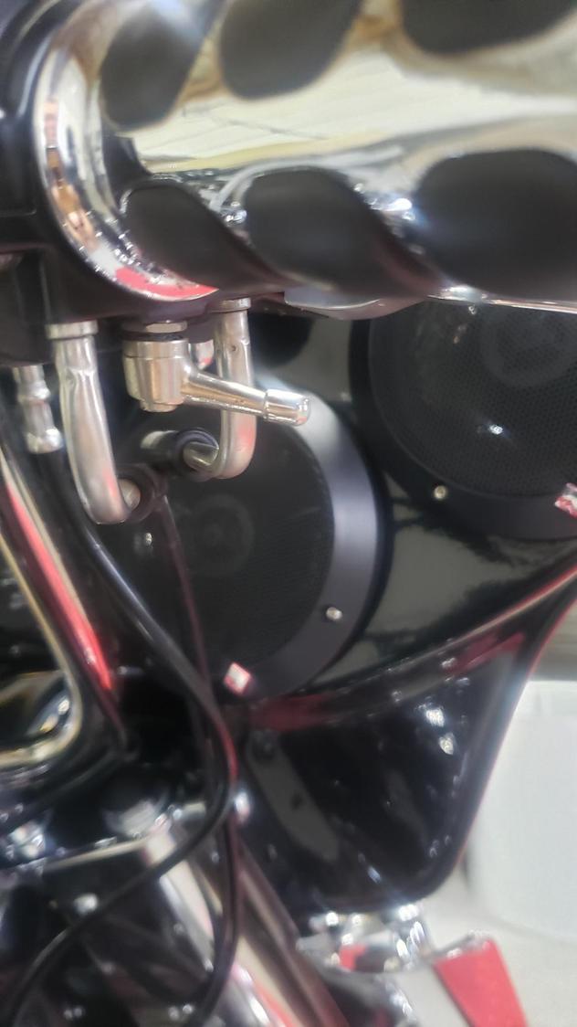

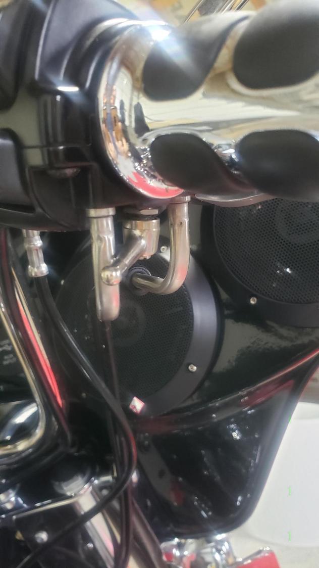

Put these up for a Member with questions
First pic is in non lock position - this is in the lock position. fits right between the push pull throttle cables & works well. This works on all bikes with the OEM wheel style throttle lock - comes in Black or chrome. Helps on long trips when the right hand needs a brake.
