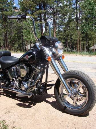

I got a 06 fatboy with a champion trike kit, 5deg oner triple trees, 12" apes, 3" risers, 1 1/4 " fat bars, can not ever take hands off grips, anytime ft end shacks lock to lock. Checking neck adjust, ft wheel spacing, wheel balance,mag wheel bent, checking all these things,. Any thoughts ? Many thanx

Steering damper may resolve your issue. Or call Champion and see what they recommend.

Tire pressures? Fall away? In my research, you run less air on the trike conversions, particularly the rear, as well as have the rear tires checked for defects and balance. Rear end issues can make the front shake.

* Are we sure the conversion was done correct? - This shouldn't be doing this
* Is everything torqued to spec?
* Is the bike in a proper 3 wheel alignment?
Ill bet its either item 2 or 3

I'm guessing it didnt have these issues when you purchased it.
When did it begin? Soon after you installed something or it gradually came on?
Process of elimination, tires, wheels, neck bearings adjustment is another neglected issue..

More info: I bought bike with wobble there. during check out found steering stem too tight, still have to check rear alignment, and 3 wheel alignment. No bent wheels, good wheel balance. after market trees w/ + 5 deg rake, smooth top tree, stem slides in from bottom. trying to figure where to notch stem so neck lock works. Probably more question for Champion!

I nave a 2002 Harley trike with the Frankenstein kit. I dont have the raked triple trees. I had a wobble when I installed the kit. I phoned Frankenstein and they said I needed the racked trees. I read the instructions for installing the racked trees They said to tighten the trees so they would not turn and then to loosen them a little so they would turn without binding. I then did this to the stock trees and low and behold the wobble was gone. The trike is a little hard to steer when going around sharp turns so I will probably get the racked trees to make it easier to steer. BUT the wobble is GONE. So I am saying tighten your steering.
