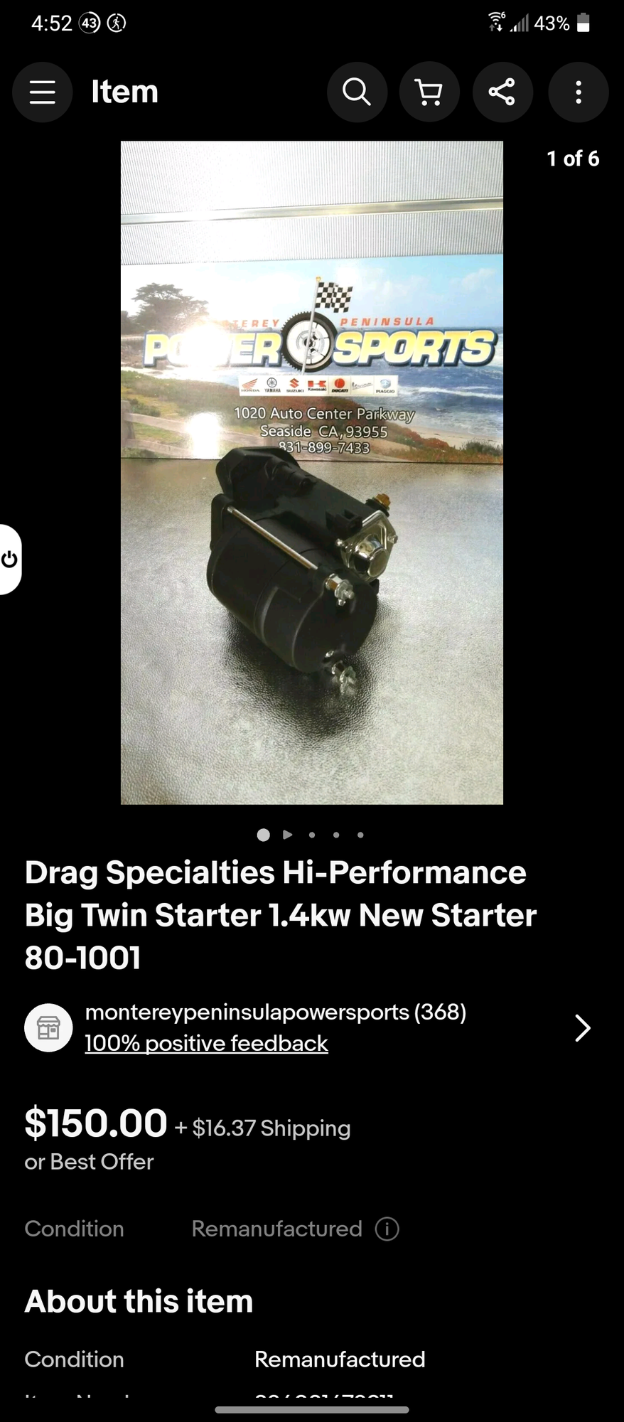

It's a rebuild drag speciality 1.4 starter.

It was load tested last Saturday at Harley Davidson. Might be that the meter is not so great, and it is a DS starter that was rebuilt. At least now it's trying to start.

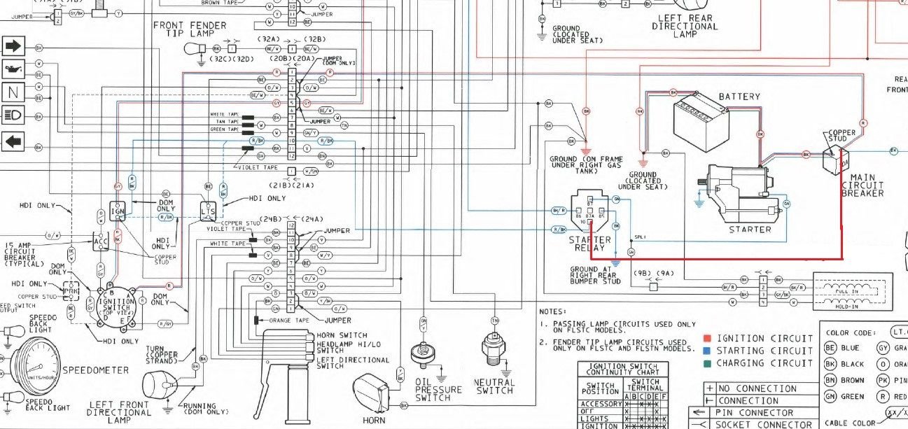

It still seems that the circuit that goes to pin 30 on the relay is not reliably providing sufficient current, but I`m not convinced that you are troubleshooting with a fully charged battery.
There is another way to wire the relay: you can run a wire from the silver stud on the main breaker, to pin 30 of the relay.
That will provide a nice current supply to pin 30, this is the way the old Softails were wired.
