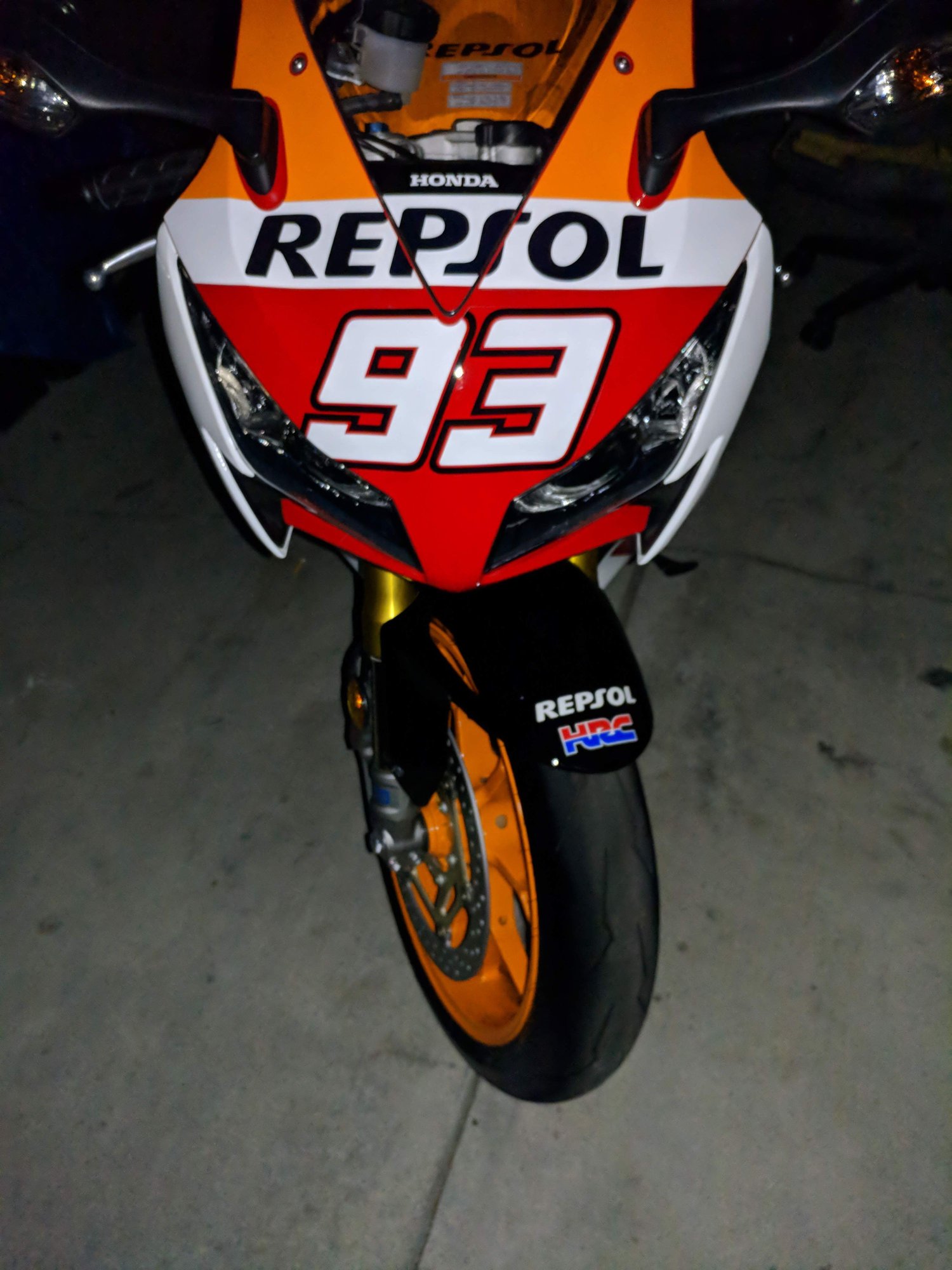

Yes compression releases, I put 10.1 to 1 wiseco Pistons in it. Total top end rebuild 490 miles ago. I'll be really pissed if the oil has been drained out of the tank, I've had enough of my brother he stole everything I own and my new 2016 CBR 1000 SP...see the picture above it was toured around the country from the factory celebrating Mark Marquez 2014-15 winning season, the 93 on the front you don't get when you buy these bike olin suspension, brembo brakes 168 hp...only 1800 miles I got it with 440.
