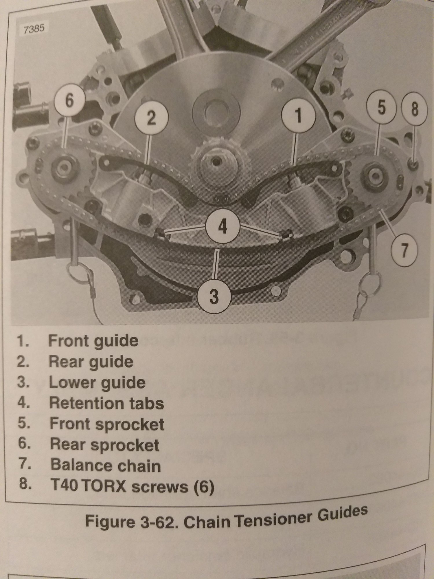

I pour in three quarts for a change with filters. I run it a brief few seconds time to the light goes off to fill filter. Turn it off , stand it up and top off about 1/8" under full. About a half quart. At the hotest temperature I have ever seen on the temperature dip stick in mine, it's reads about at top of stick.
It's also quite bubbly that raises it some. That's because is a dry sump (mostly) and that is oil pulled from sump.
There is always about a 1.5" inches of oil on crank side because that's how high the lip is that the pick up hole sits below it.
On the cam side galley where the oil pump sits, The oil in there is up to where the crank shaft comes thru to drive oil pump and timing chain.
Your two balance lobes are also driven with another sprocket and chain. That sprocket is on that side but on the crank case side .
That extra oil makes sure balance chain and inner cam bearings get oil.
