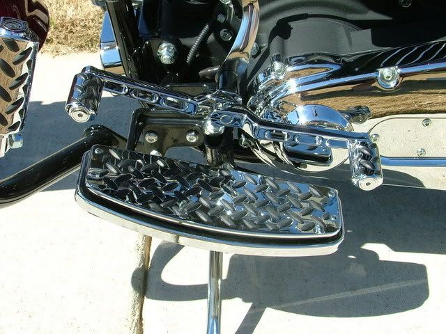

I just bought an 05 Deluxe and want to change the floorboards from stock to ones like on a SG so I can use the diamond plate style D-shaped inserts. Anyone else do this and if so what parts do I need? Do I use the same mounts.

like this?

Actually she wants these:

you will need the floorboards from a fatboy or one of the other models with that style . you can usually find them on e bay for about $30 to 50 dollars. new from harley about $120 dollars if i remember correct . then you will have to buy the inserts they have rubber plugs on the back side that you push through the holes on the floor board a little dish detergent will help you push them through. I have the same floor boards that you need on my ride but have a different insert check my gallery for a detailed picture. you will probaley bend the old inserts taking them out . the floorboards are easy to remove and install on your bike

You will need to do as nikonf8 said and change out the floorboard pans, but if your going to do that, you might want to consider the extended reach riders floorboards that Harley makes. P/N 50409-04 The mounting brackets on the bottom of the boards are further back making the floorboard 2 inches forward. Harley says that they are for the touring modles only but they fit the softails with the D shaped floorbards no problem. I have them on my fatboy. And for $79.95 there not to bad in price. I would advise you get an EZ brake pedel or an extended break pedel of some sort if you go this route though, it will just make it easier to use the rear brake.
