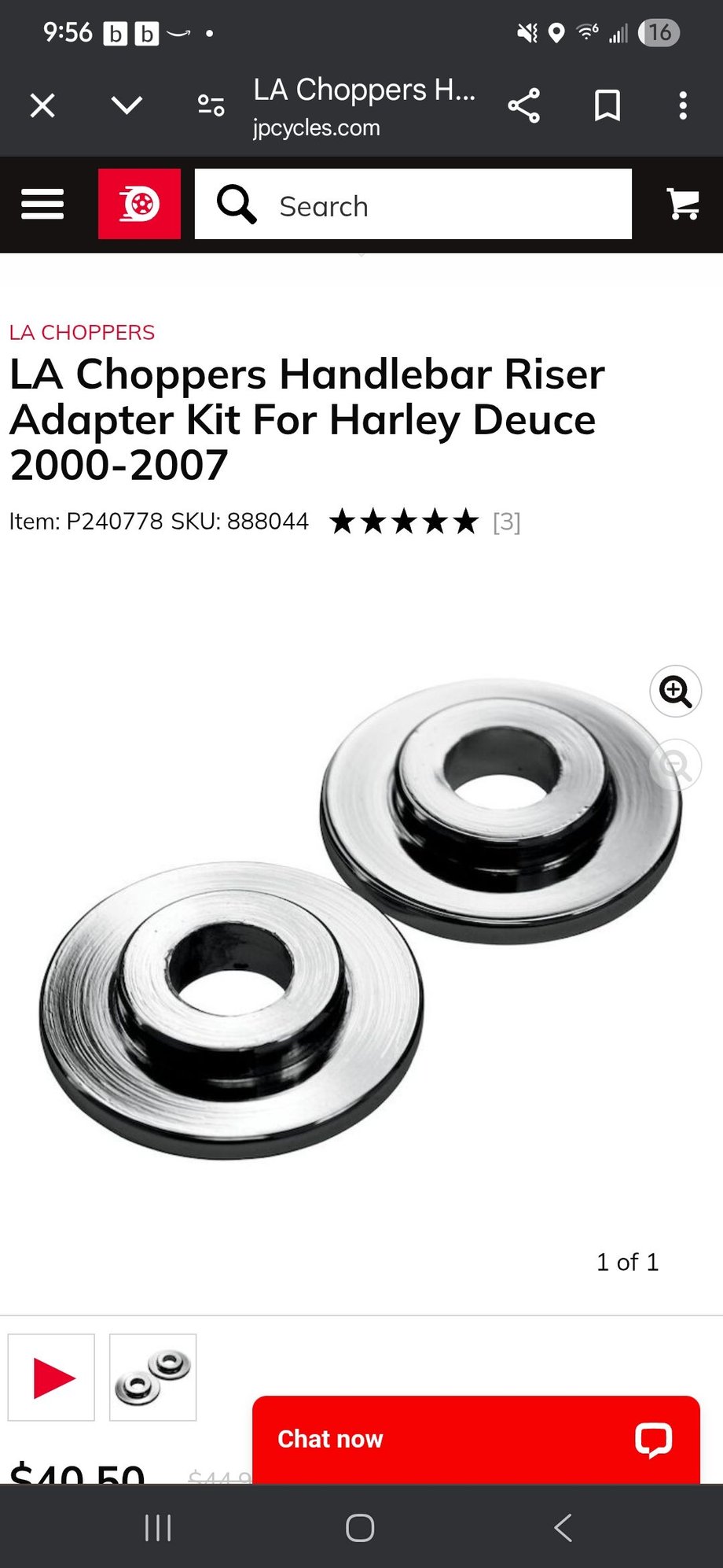

Hello everyone. Tonight I was going to swap my stock pullback risers and bars on my 2000 Deuce with a 1.5" riser and 14" apes. Unfortunately, as I pulled the risers and bars off, I found out Deuce triples are different and have a recessed lip in them. I found the triple/riser adapters on LA Choppers and Carlini. My question is once I buy a set and pop them in, it would just be riser on adapter, on triple? Maybe I'm having a brain fart, but it seems like there's no way to get any kind of bushings mounted. Hoping someone has done this before, and can hit me with some knowledge on the issue at hand. Thanks in advance, cheers!

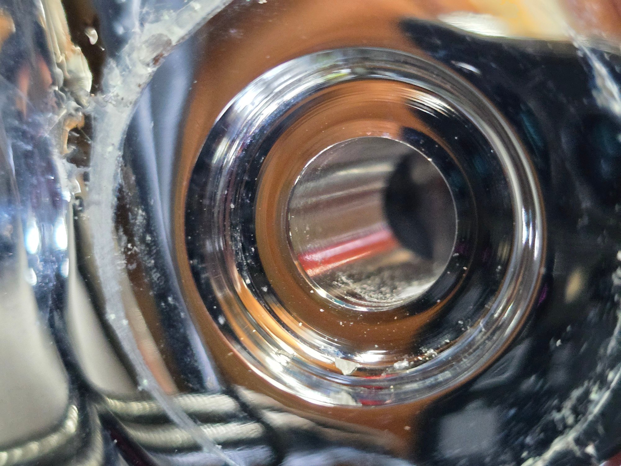

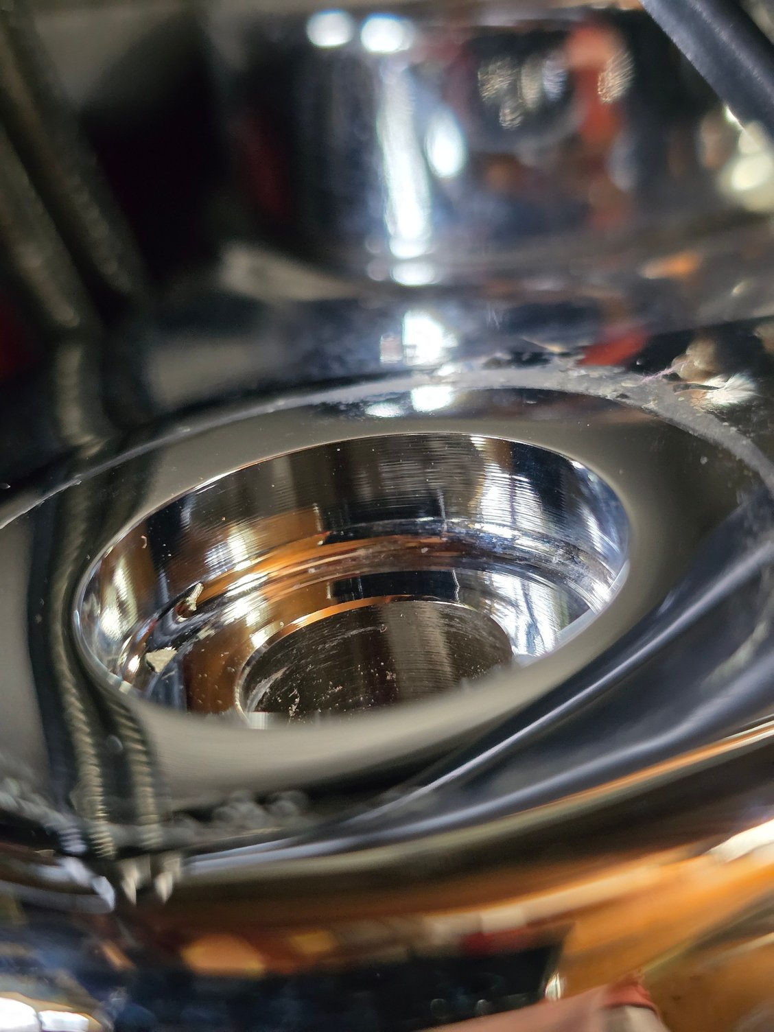

Heres a couple. Recessed housing, all solid.

This riser, and these bars. Had these bars on my fxdwg and I swear they're the most comfortable apes I've ever ridden.

The Deuce top triple tree will not accept any bushings. I have a 2001 Deuce and replaced the triple trees with ones from a FXSTB for the sole purpose of installing poly bushings (and the chrome was bubbling quite a bit). I was getting too much vibration on my 12" apes. Since putting those on vibration has been greatly reduced. The adapter kit mentioned above will act as a shim for the riser bolts, otherwise the risers could move around on the trees. Hope this helps.
