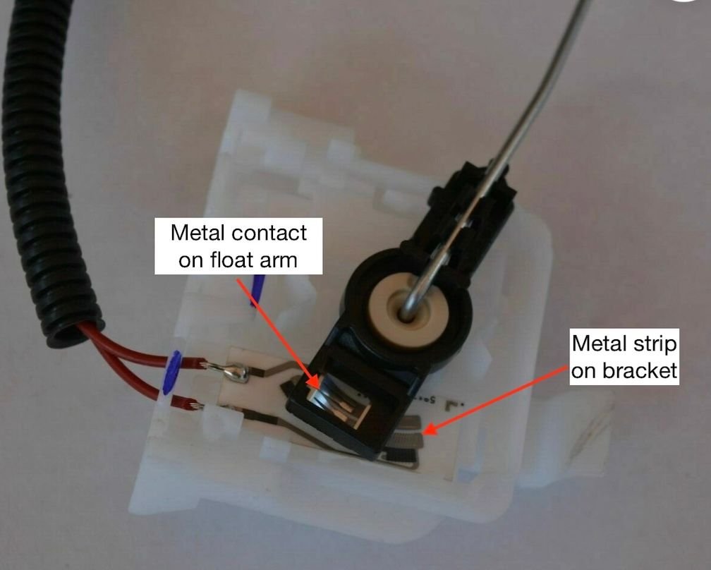

So you can understand what I am talking about, here is a pic from eBay, of your Fuel Level Sending unit #75276-08. There are both "A" and "B" versions, they may be identical, I haven't seen both side by side. They will work the same.
In this second picture you can see there is a metal strip attached to the bracket. Then there is a metal contact attached to the float arm. As the float contact slides up & down that metal strip on the bracket, dictated by the fuel level float moving up & down, the resistance changes. It is those contacts that can get worn out and/or corroded, that will affect the signal.
I hope some of this information helps.
