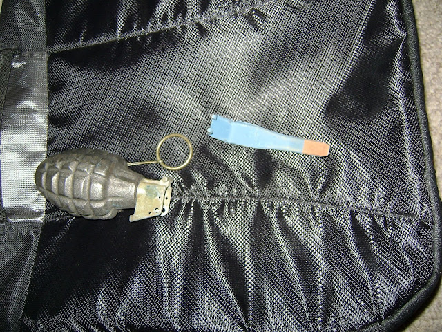

So I got inspired that there is a place to showcase your DIY stuff and decided to follow through with this idea I had for pegs....

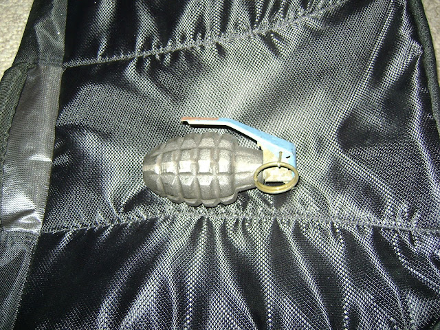

Take a Grenade.... a dummy grenade... dummy. Available at my Army/Navy store for 9 bucks.

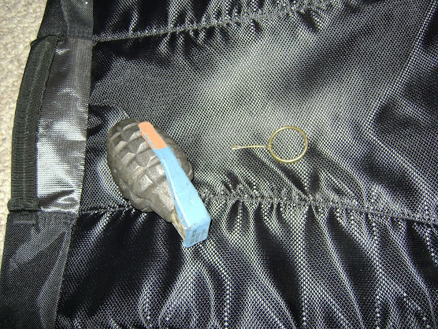

Pull the pin! At this point you will have 3 seconds to replace it if you are unsure if the grenade is an inert and decomissioned pineapple.... or not.
Remove the spoon if 3 seconds passed without a VERY large bang.

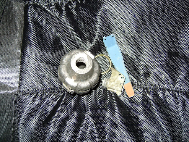

Unscrew the fusing assembly and remove it from the grenade body.

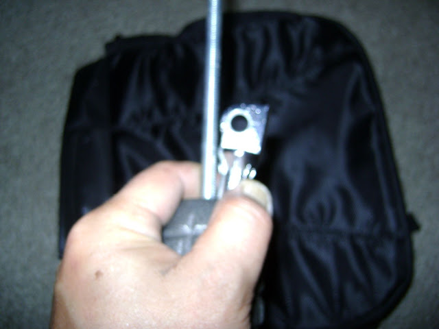

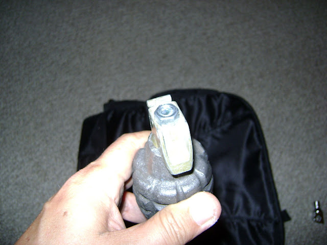

Drill out the fuse assembly with a 5/16ths bit. I used a drill press... feel free to gouge at yours with a handheld and a vice.

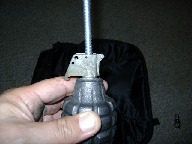

Once you drill out the fuse assembly, reinstall to the grenade body. I used some 5/16ths allthread 20 turns per inch (2 bucks at home depot) and slipped it through the fuse assembly and out the decomissioning hole at the bottom.
Wow! What a coincedence! A 5/16ths nut (10 cents at home depot) sits right there in the fuse assembly!
And now the reason for all of this 5/16ths crap...
Kuryakyn part number 8880. 20 bucks. *shrug* got em half off at a shop. Just lucky I guess.
Heres a link if you want.
http://www.kuryakyn.com/index.cfm/go...cID/0/IMID/564
5/16ths 20 turns per inch happens to be what these particular serrated male adapters require.
So measure a half inch down from the bottom of the pineapple, whack it off with whatever you whack off with. *snicker*
I whacked mine with a dremel.
Screw on the adapter. replace the spoon, thread the pin back in and bend it so it doesnt fall out... slap em on your passenger pegs and deter piggybacking. Enjoy the smiles from cage drivers at redlights.

Dagerazod,
I like the grenade idea, but if I were you I would get rid of the Home Depot threaded rod and use a 5/16"X20 grade 5 or 8 bolt with a grip length (unthreaded section) that will fit through the grenade but still allow you to put a nut where you have it in the fuse assembly.
That kind of threaded rod is very soft and the pressure your going to put on it with your foot (especially when doing a fast or hard stop) it will sooner or later (probably sooner) bend and or break on you.
Using a grade 5 or better yet 8 bolt will go a long way towards keeping things together a LOT longer.

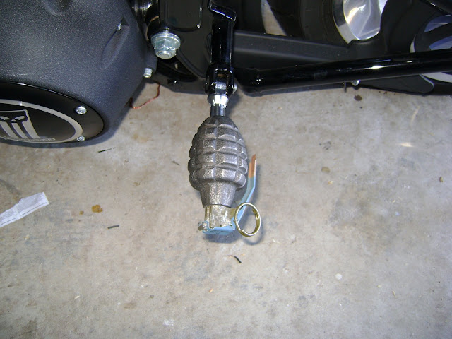

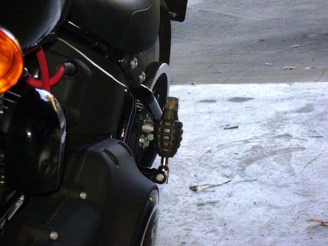

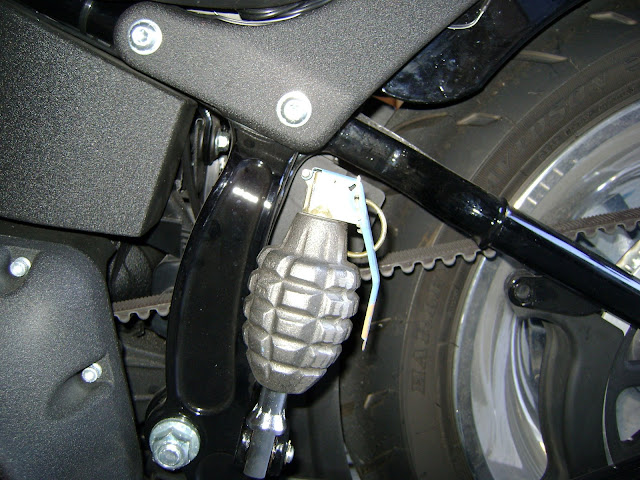

So I took your advice, replaced the allthread with the grade 8's and slapped em on the bike!
Thanks for the input!
Im thinking of drilling out a larger hole in the bottom of the nade so the adapter recesses into the body more. Although... they scream NOT REALLY LIVE ORDINANCE with the adapters hanging out like that... might prevent LEO questions.

I like it a lot. But I think you might want to rotate the spoons to the front. In back like that is fine, but anyone actually using them is likely to hit them with their feet and bend them out of shape on you. In front they are less likely to be hit or caught on a boot heel.
