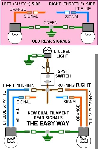

Originally Posted by evil_monster
I have a 2000 heritage. How can I mod the turn signals to include running lights?
I'd also like to mod the spots on the front to come on not only when the low beams are on..but even when high beams are on.
anyone??
I'm guessing that your talking about the rear turn signals, cause the fronts are already wired for the run function.
Ther's a couple of different ways to make them work that way. The fastest and easiest is to get a run, turn, brake module from somplace like Biketronics or your local Harley dealer. Its a plug and play setup that litterally plugs into the existing harness (even has the right plugs) and does exactly what your asking for. The one from Harley also comes with red lenses to replace the existing amber ones, I'm not sure about the ones from other outlets. Both of the ones I mentioned are avalable for around $50 and take about 10 minutes to install. With most of that time being devoted to taking the seat off and replacing it.
The other is a bit tougher and involves replacing the stock turn signals with ones from the front of the bike. You can get them off evil-bay for a decent price.
Then splicing them into the existing wire harness under the fender like this.
Just ignore the part showing the switch (SPST SWITCH) and use a straight wire instead. The diagram was originally intended to show the setup if you have amber lenses and they are illegal as rear running lights, but they are OK as turn signals in all states.
Its abit harder to do, but it does offer the virtue of having two bulb elements lighting up with the brake or turn signals making them a bit brighter.
hehe...not on this one! I just double checked... no running lights on the front. Only turns.
If your interested in having the Aux lights work all the time. Your going to have to find a wireing digram for your bike (in the back of the service manual) and move the power supply line from the low beam circuit to its own dedicated, AND FUSED power source. Preferrably using a switched power line so it not on all the time like it would be if it were wired directly to the battery. Even if it has a switch, and many bikes seem to have them for those lights. You still want to have that switch fed from a switched line. That way even if the lights are switched on, they will not light unless the ignition switch is in either the IGN or the ACC position.
Wired to the battery it would be all to easy to forget to turn them off in daylight and have them kill your battery on you.
there's already a switch installed.
I think there may be another solution.
If it's drawing power from the low beam, I should be able to simply install a diode from the high beam to the lights. This will allow current to flow from the high beam to the lights...but when the low beams are on, the diode will prevent power from going to the highbeam circuit.
Mine are always on. I never mess with the switch but have tested it so I know it works.
Thanks for the information and the diagrams. They'll be helpful as I learn this bike.
