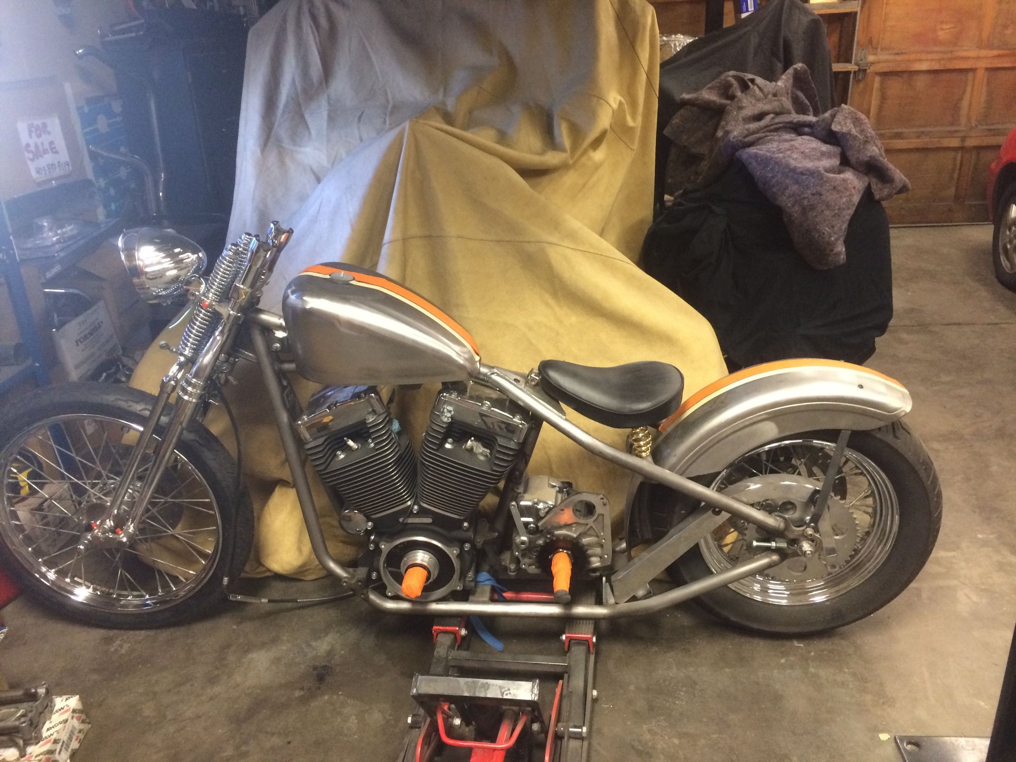

Originally Posted by sandmancustoms
someone help me out here please. will a tc88b engine fit in an evolution softail frame ( 98 heritage)?
The answer is absolutely yes. All you need is the right adaptor on the back of the A motor
to bolt directly into your stock evolution frame. 1999 to 2005 will also except the evolution primaries directly bolted to them.
