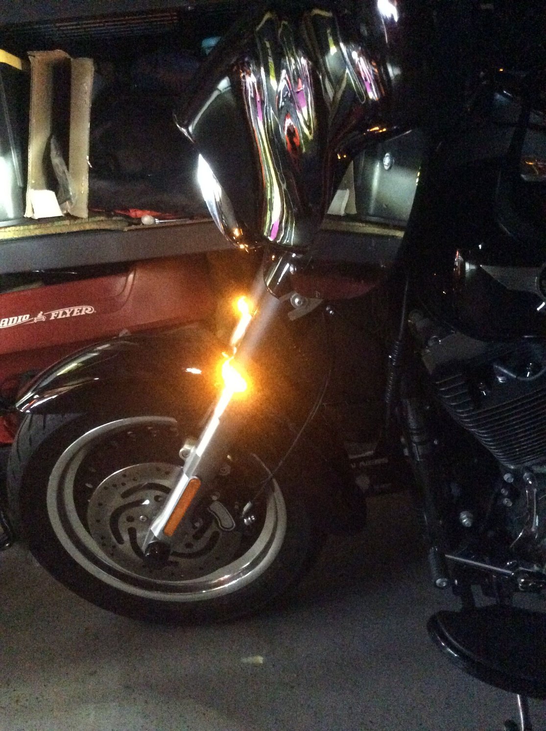

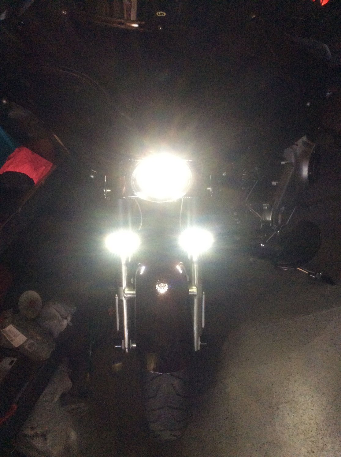

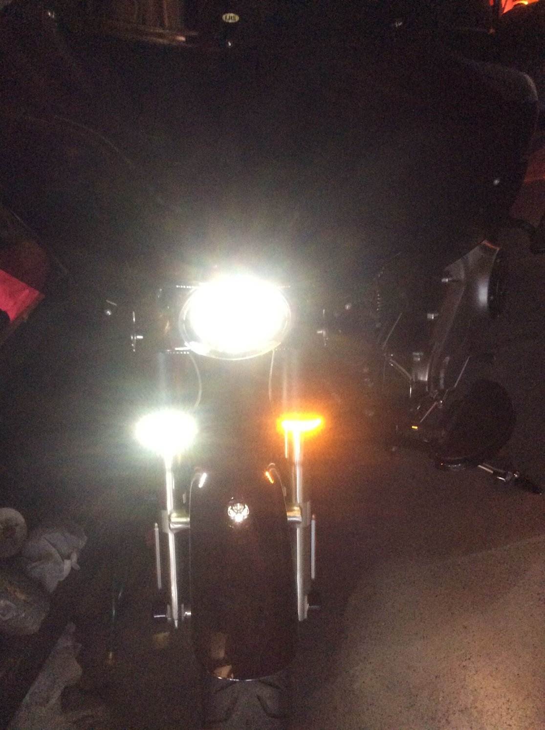

That's showing the various phases. They're white running lights all the time, until you use the turn signal, then the one becomes a flashing Amber light or hazards, and then both flash Amber.
Oh, and no, I didn't need a module or resistor. They flash at normal speed, but my dash indicator does flash faster. I just ignore it.

super bright, there you go Scott!

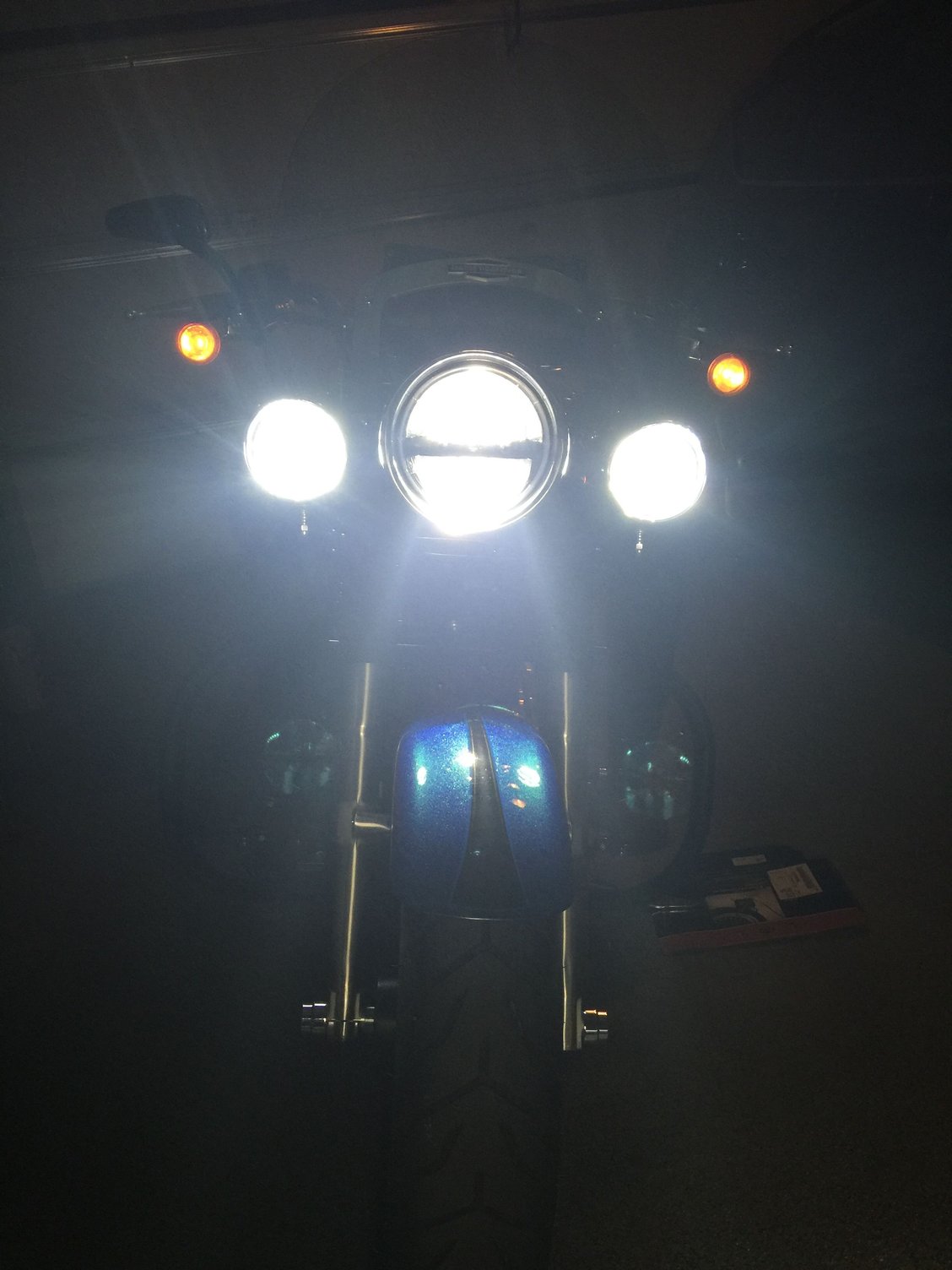

I am happy with my set up, 7" LED Truck-lite and 2 x 4" LED Auxiliary lights. I bypassed the Lo/High switching and my Auxiliary lights stay on all the time, whether I have the high or Lo beam lit up.
It looks like I am driving in daylight in the dark.

Here is a better picture of my new signal set up. Got my iPhone camera replaced today by a so called "Genius". If he was a Genius, why is he working at an Apple store?
