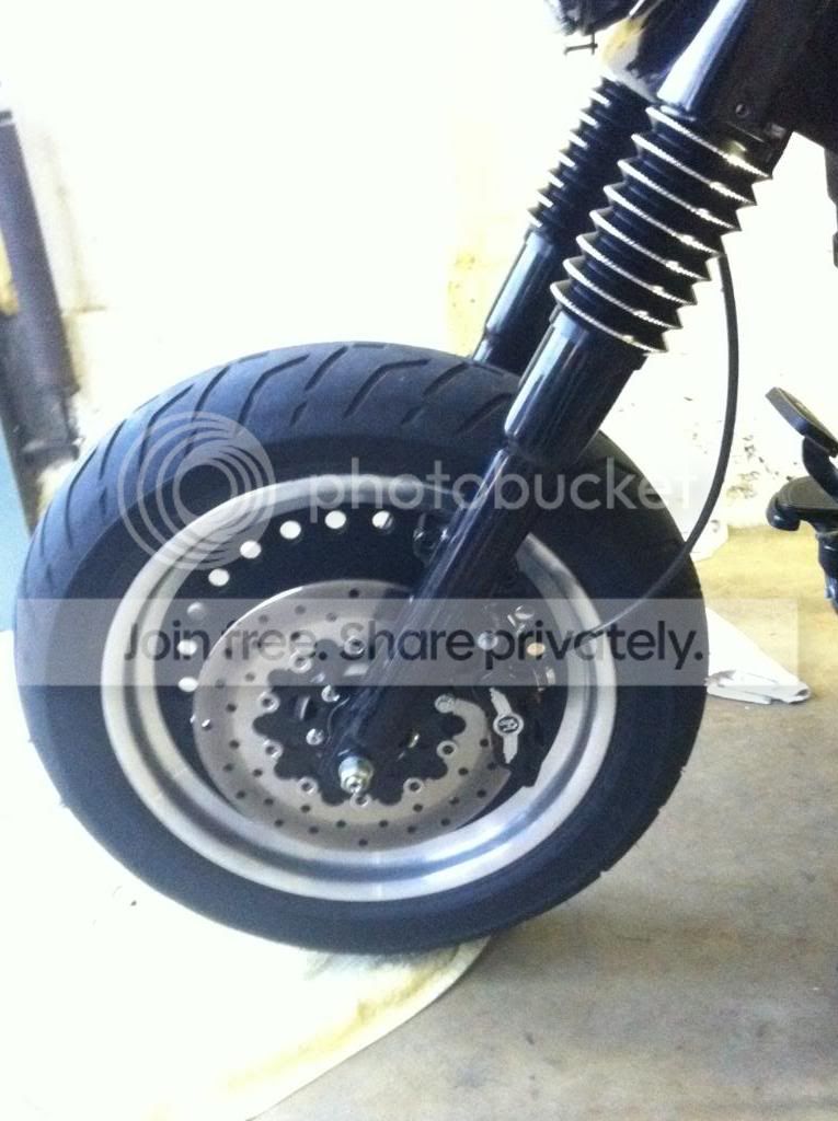

I have been running the Jaybrake J-Six Ultra for about two months now..
About 600 miles.... Love it.
Really good feel and feedback. Don't think you''ll be disappointed in it,
super solid.. I got the black powder coat... very easy replacement
for the OEM... simply take off the HD and slap on the Jaybrake, no
additional parts needed.
