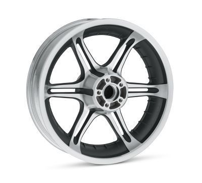

I'd look at these. Stock Harley bolt on for Heritage Softail
Probably look better on a dark colored bike,
I dunno about my white one
