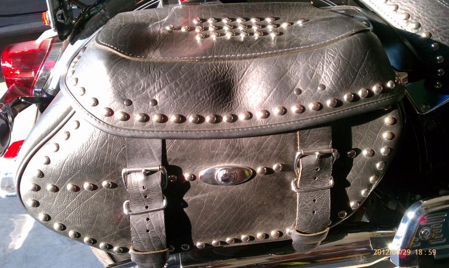

Nice bike. You need to get some Papa saddlebag inserts! Check out my before/after pics.
