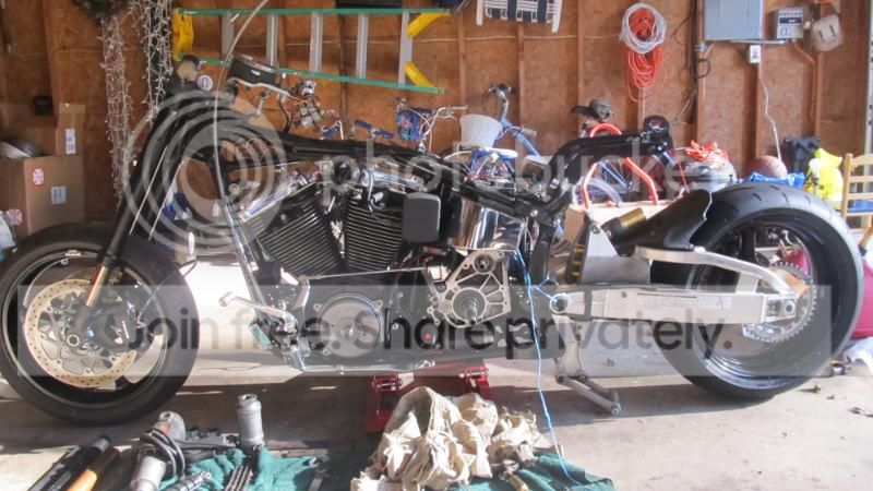

Ok, dropped off the GSXR triple and the Softail triple at the shop today to swap the Harley stem into the GSXR triple.
I checked the UPS tracking site and my front end is "out for delivery"

Hey, I think the twine holding the swingarm on and the ratchet through the steering head should be fine at highway speeds, no wobble or nothin!!!

I am gonna run the short shot pipes that are on there. That rear end is going to be sold. One pain in the *** with this type of bike building is that you dont know what will work unless you buy it and try and fit it. The 1000RR arm is too big and wide to fit in the frame. It would require machine work to get in and then chain run and wheel would also need tweaking. the $$$ would add up quick.
On the other hand a 600RR swinger is an inch or two narrower, will fit in the frame with no machine work. Then the arm just needs to be centered and hard mounted. Also, I will run a 180 tire on the 600 wheel rather than the 190 on the 1000RR. The 600 arm will fit just like the gixxer arm I had mocked in there earlier. The reason the CBR arm is preferred is the top shock mount does not have to be built.
So the 600 arm and parts are on the way, $150.00 total, just have to pick a wheel. I think that would be cheaper than trying to get the 1000 arm and wheel to work.
****, I went big right out of the gate. I should get most of my $$ back on the parts. Just take a small hit on shipping. Not too bad.
Anyways, starting to make some good progress. The 1000RR rear end was a small stumble, dont know till ya try. Hope to have the triple back with the Harley stem by next week then I can at least get the front end squared away.
