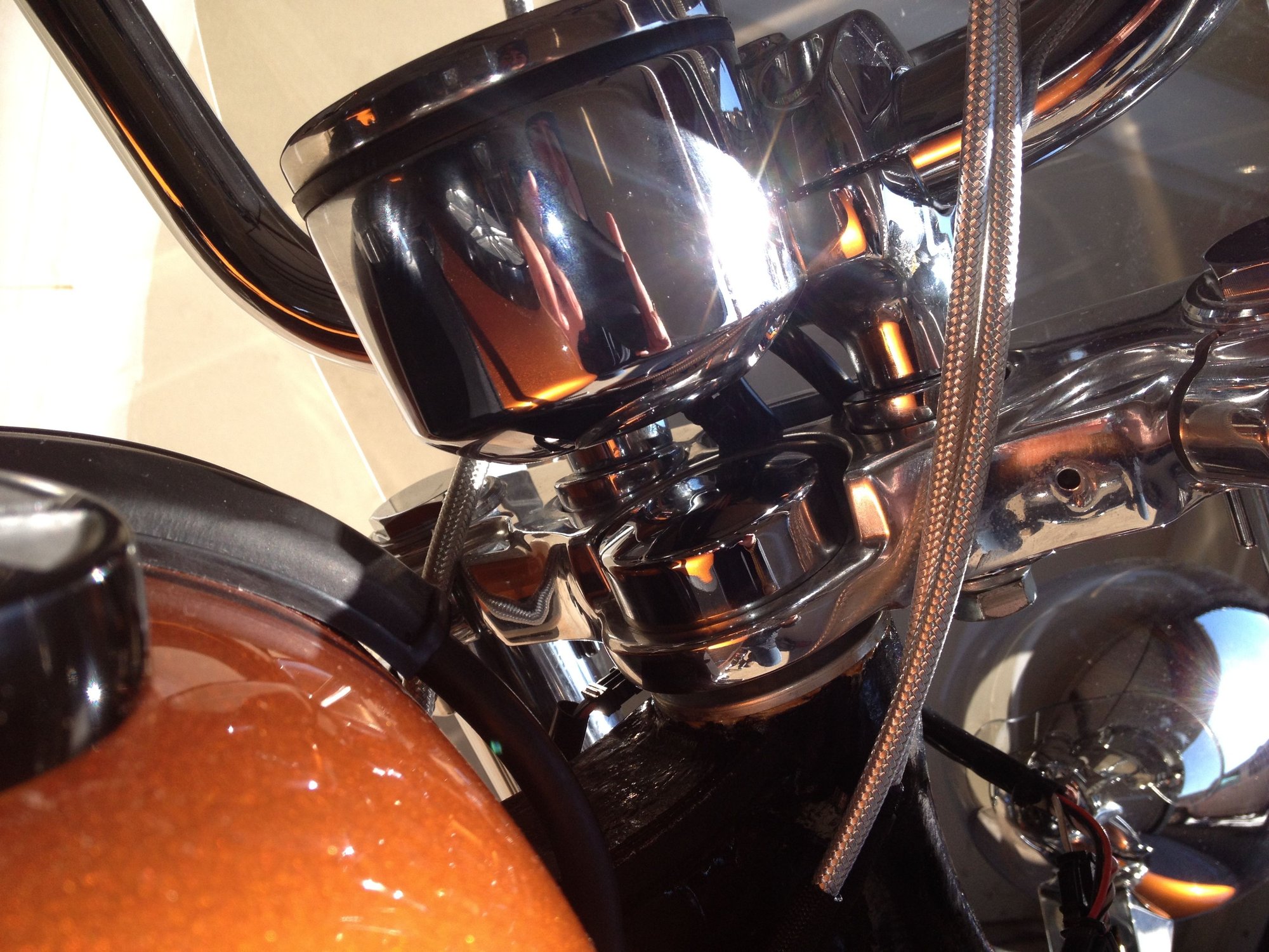

Consider the 10 degree riser bushings that are available through Dennis Kirk. You may well find ways to use them that will help solve your problem.
In order to gain riding comfort while reducing the visual impact of apes, I installed 14" apes on short CVO risers and did a 3" tank lift using a DK Custom kit (see my Avatar). To accomplish this, I mounted the risers on 10 degree bushings, angled forward, so the speedo housing clears my tank.
I'm not necessarily suggesting you go through all that, (you'd need new cables too and the exercise is quite expensive), but do consider those 10 degree bushings (85 bux or so) as you think through your solutions.

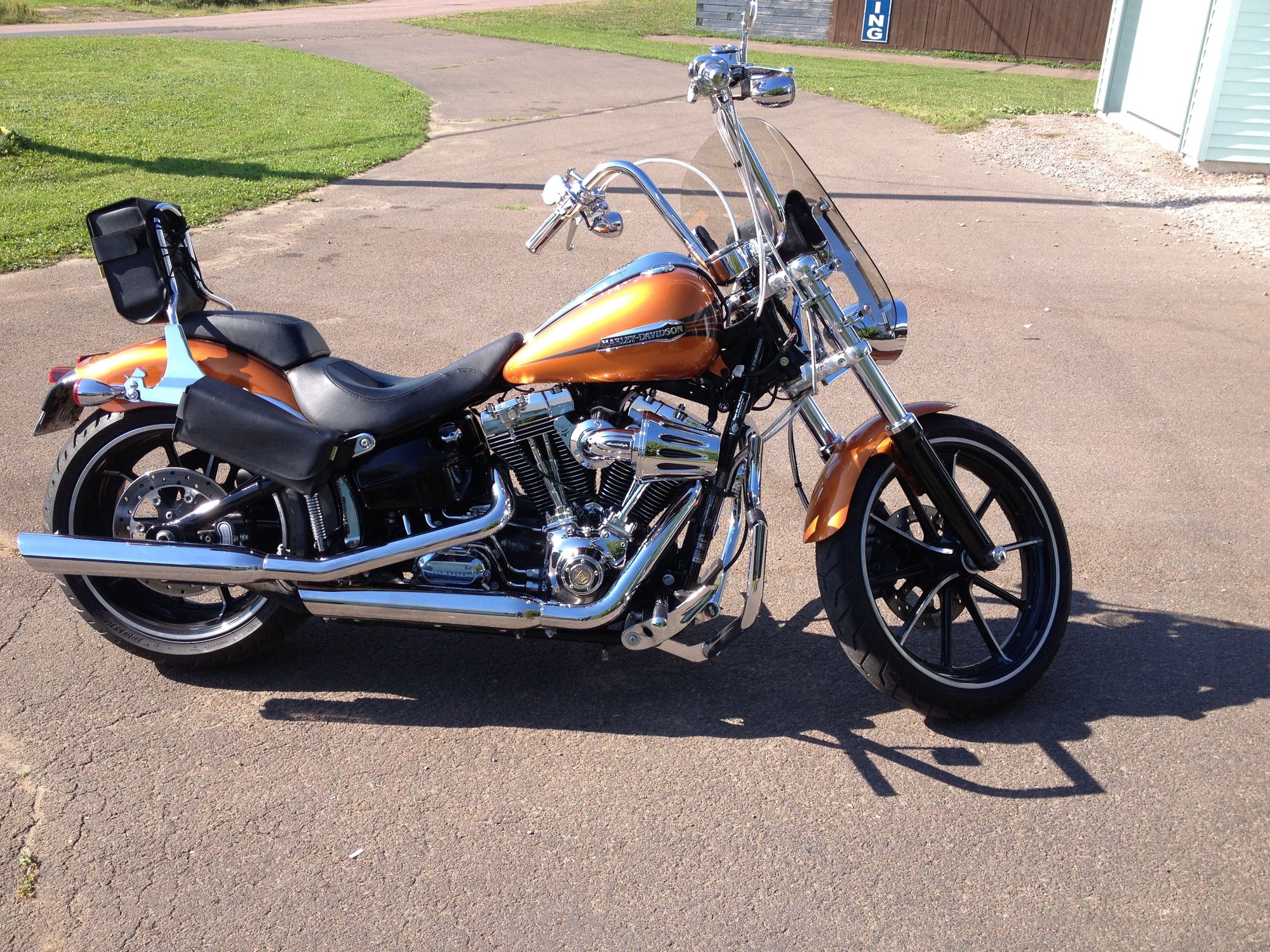

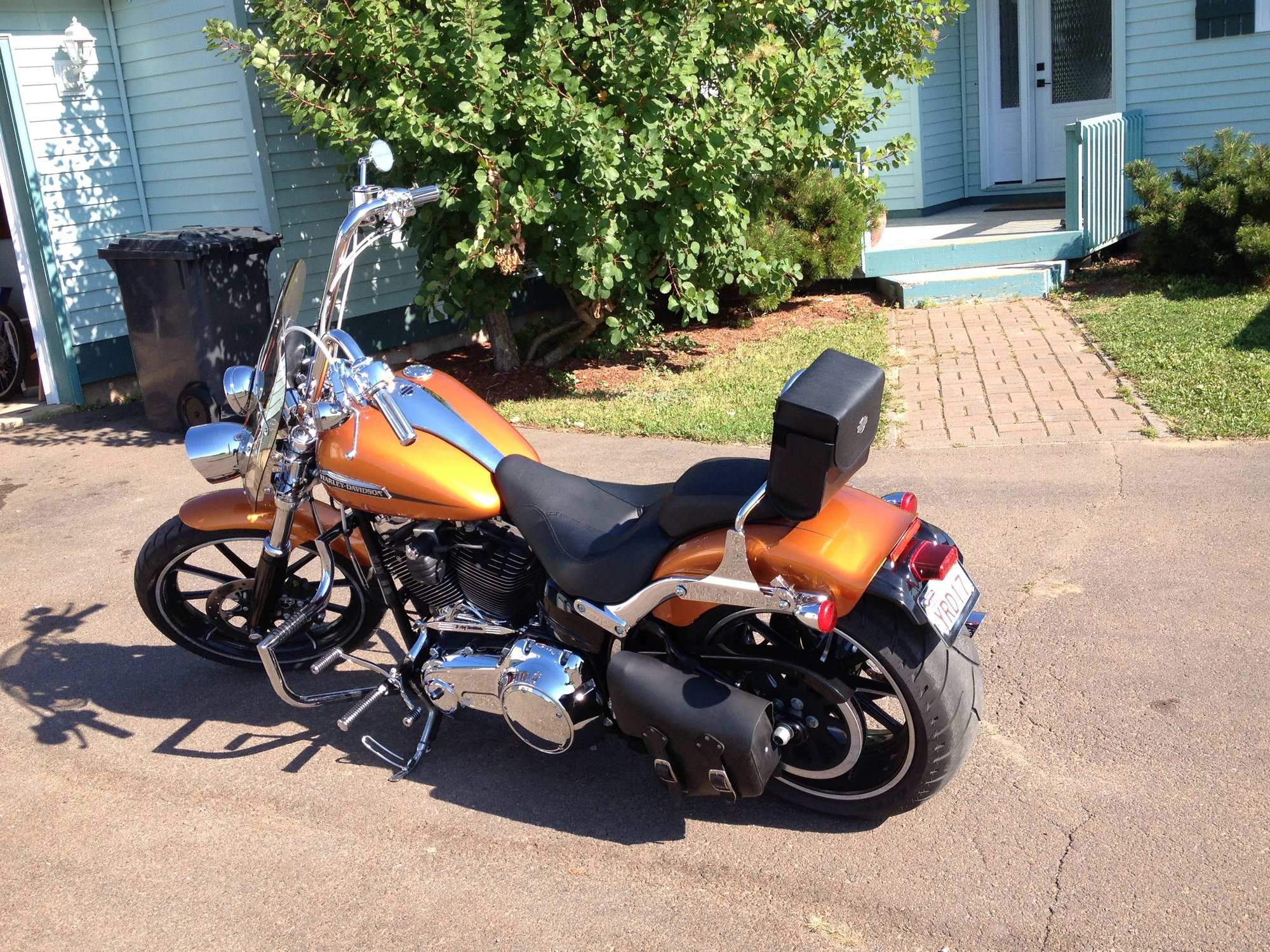

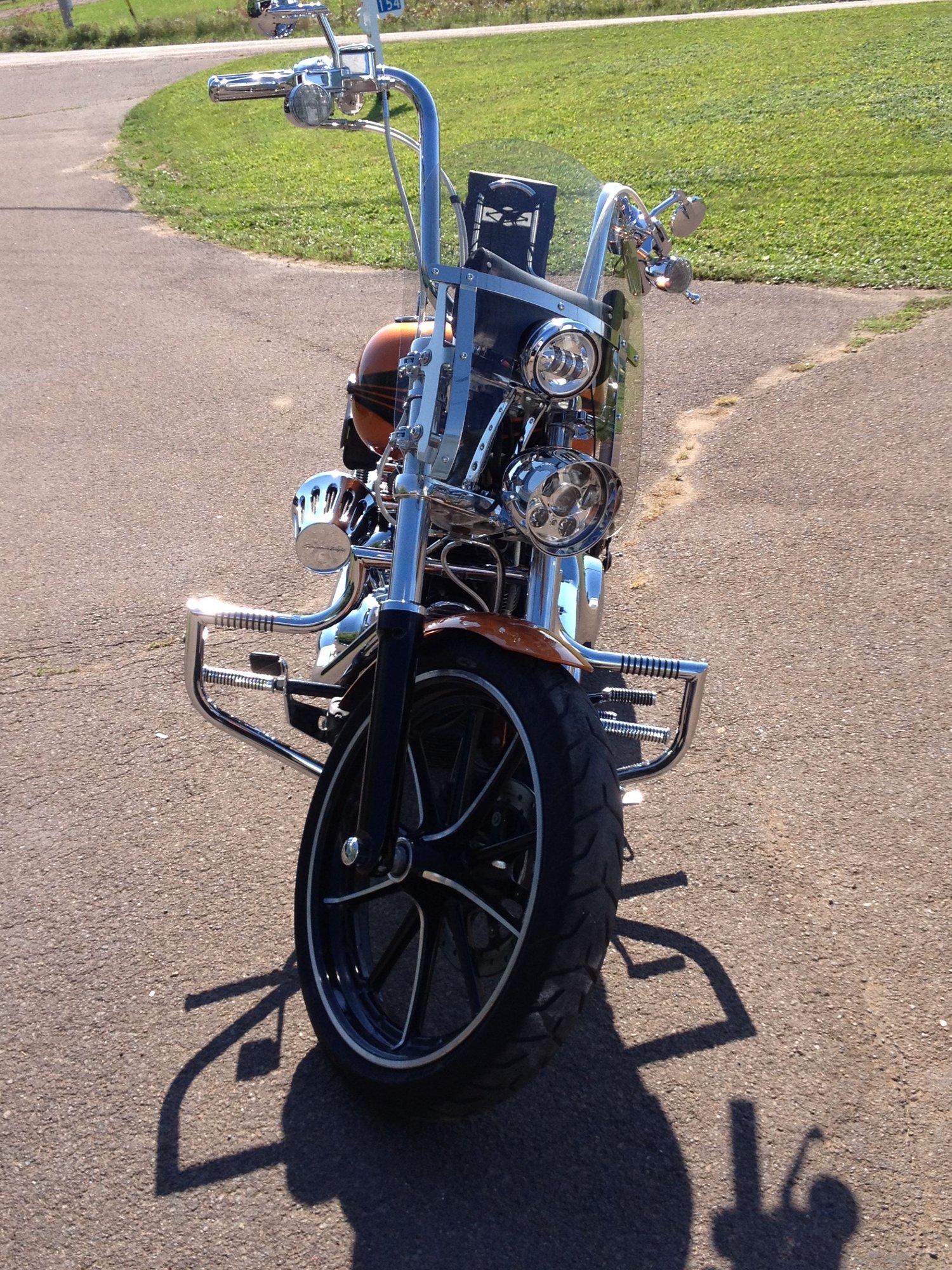

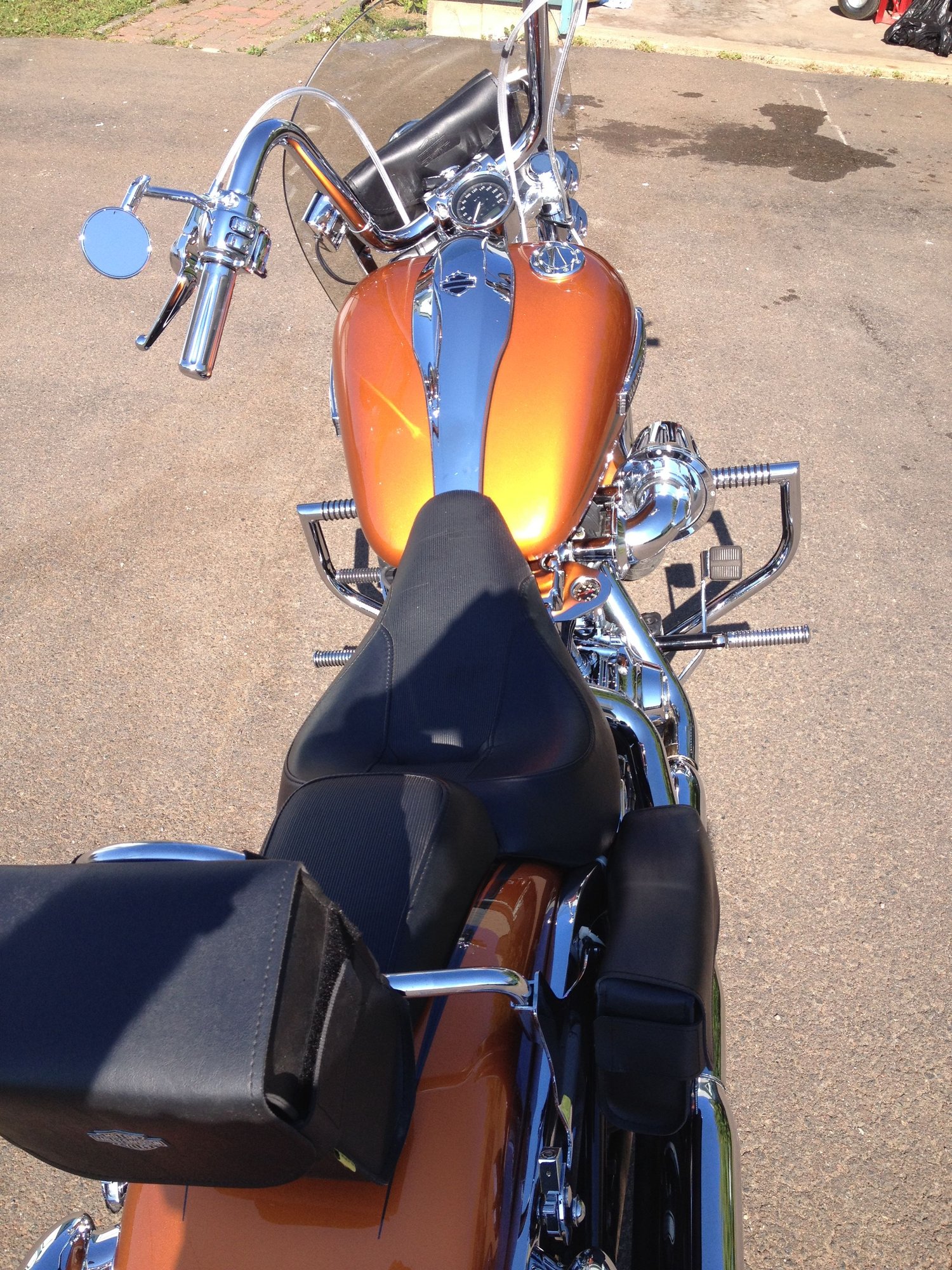

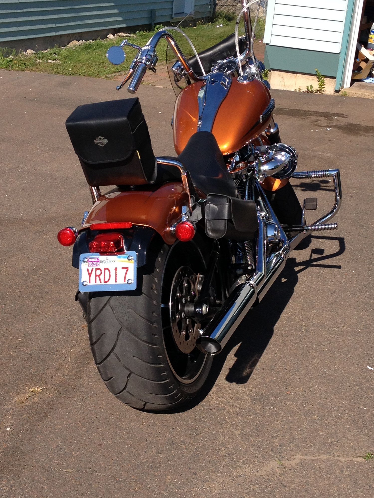

Been awhile since I posted pics, (except for above ). Here goes:
A 250 rear tire, Lollipop baffles, chromed Blackline dash, 3" tank lift, heel-toe shifter and a swapped out tank badge are some of the mods you can see. A 204 cam (and SE Supertune) are mods you can't see. FWIW I'm running Red Line products in all 3 holes through a PurePower permanent 22 micron (Absolute) filter. Thats about it, thanx for watching .
