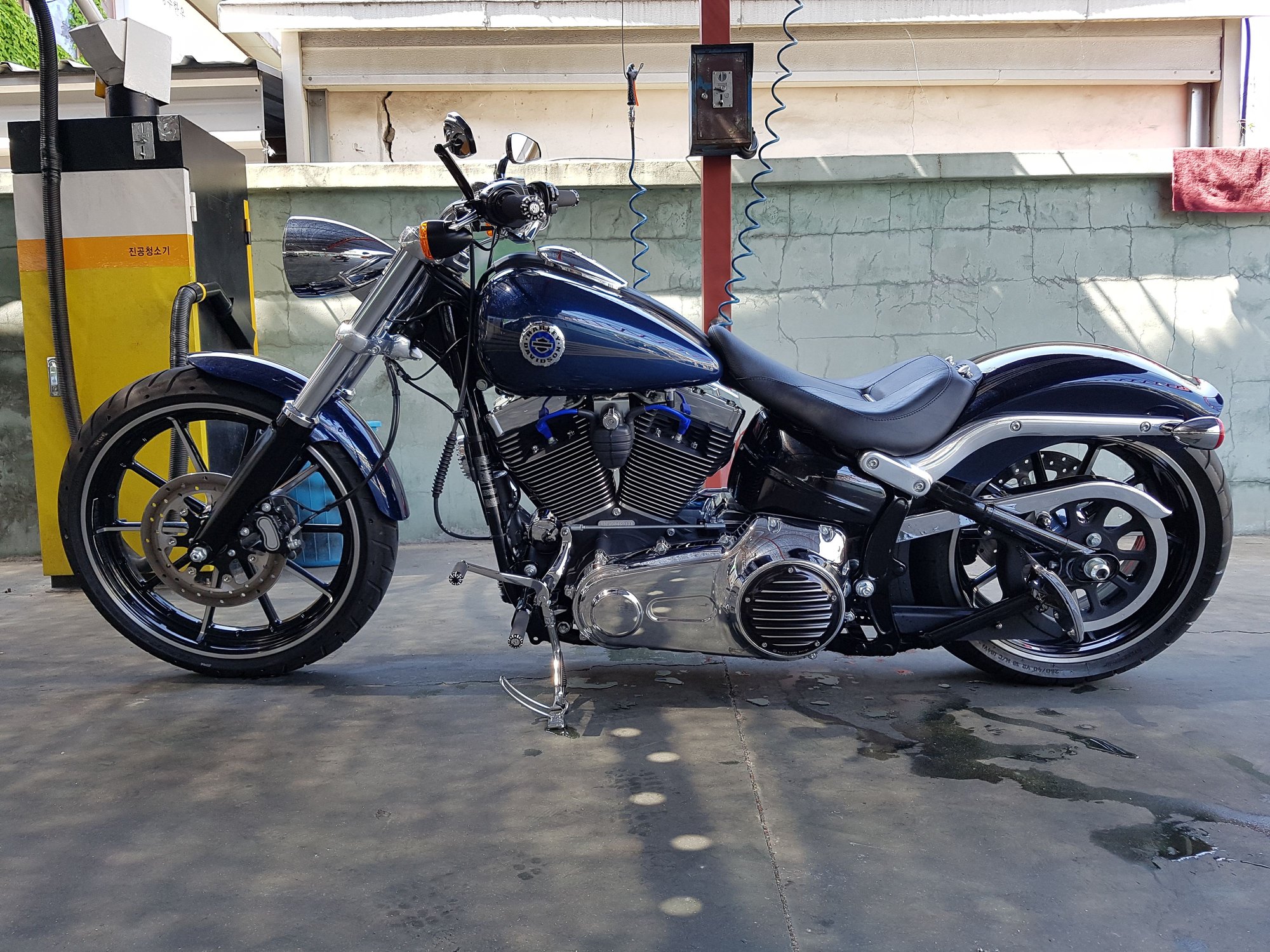

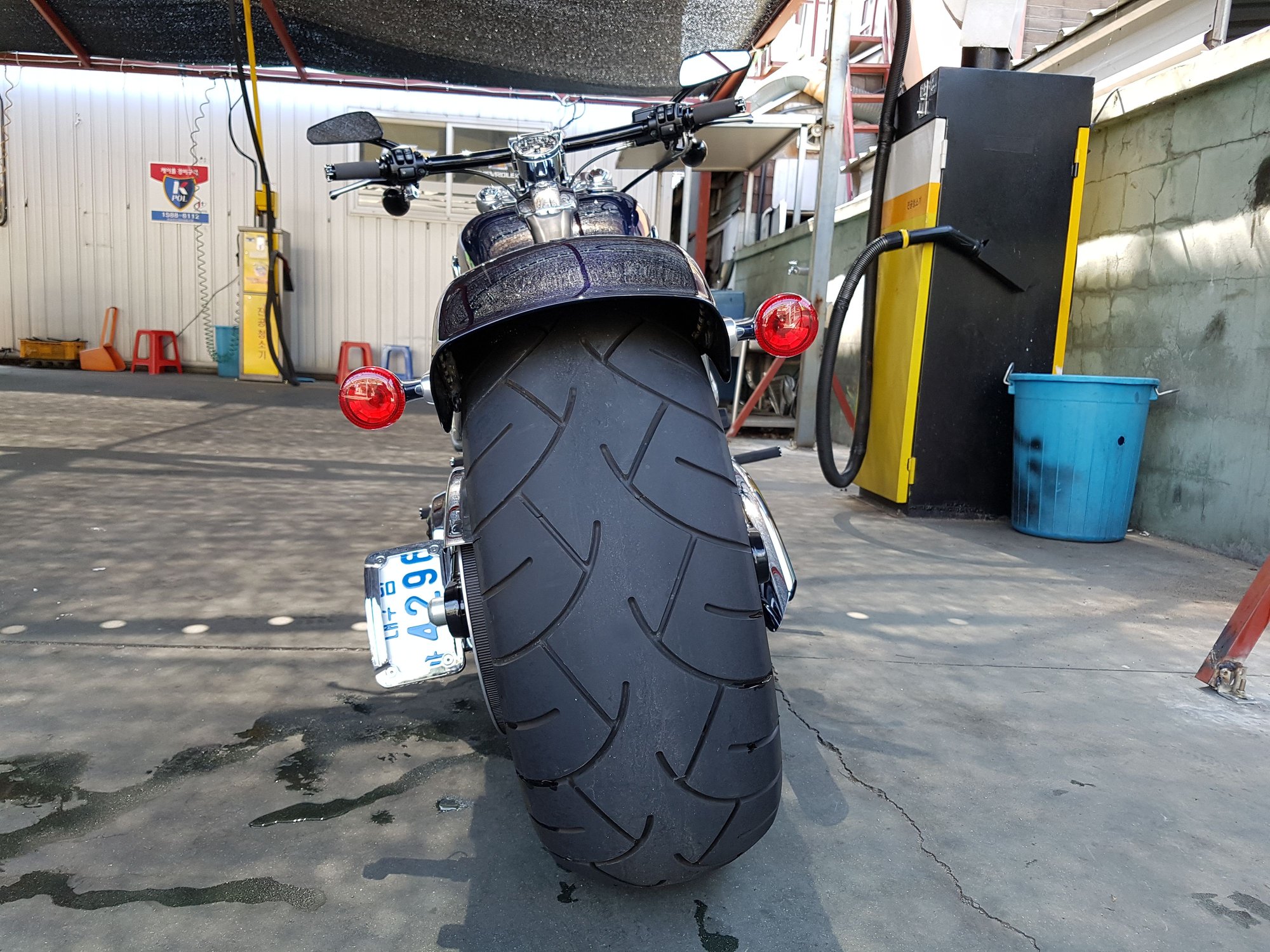

Default ** Work in progress / 2013 BB Pearl **
Bumped the back tire to the Metzeler ME 880 260, lowered it slightly, added an under fender custom LED brake light, moved the license plate to the swingarm, swapped to the one-up Harley seat (wish there was a LePera for this model), changed the headlamp to a little different design, SE tuner, V@H pipes, Kuryakn intake, RSD grips, levers (fit kind of loose, a little disappointing / too much play), RSD pegs, RSD brake cylinder covers, Derby, timer, so on and so forth.....little stiff after the drop, but getting used to it, just need to take it easy around sharp corners so I don't grind the case...
Mike in Korea....

Originally Posted by MTC_1964
...... just need to take it easy around sharp corners so I don't grind the case...
Mike in Korea....
Hey man, fixing the FRONT suspension will really help out with the bikes lean angles. Worth every cent and every second of effort.... and then some.

[QUOTE=MTC_1964;15205740]Bumped the back tire to the Metzeler ME 880 260, lowered it slightly, added an under fender custom LED brake light, moved the license plate to the swingarm, swapped to the one-up Harley seat (wish there was a LePera for this model), changed the headlamp to a little different design, SE tuner, V@H pipes, Kuryakn intake, RSD grips, levers (fit kind of loose, a little disappointing / too much play), RSD pegs, RSD brake cylinder covers, Derby, timer, so on and so forth.....little stiff after the drop, but getting used to it, just need to take it easy around sharp corners so I don't grind the case...
Mike in Korea....
Nice Bike! Quick question what license plate mount did you use? Did you add a light?
