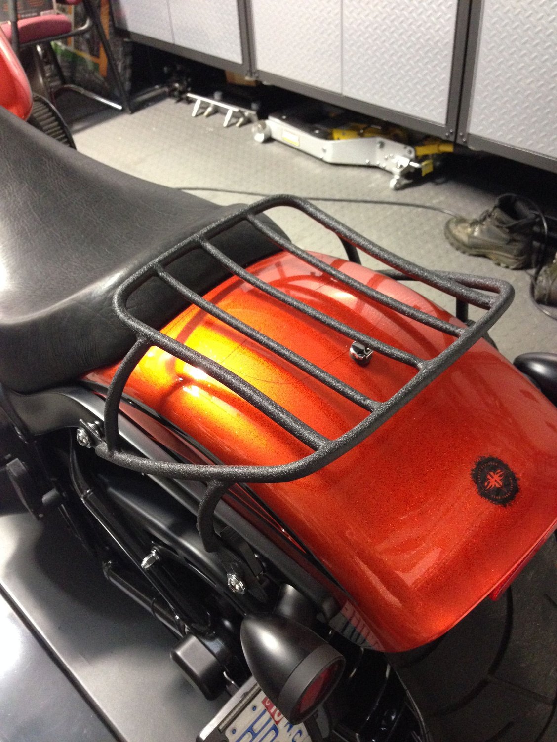

If interested... just listed my Breakout quick release Solo Rear Fender Rack for sale on eBay...
