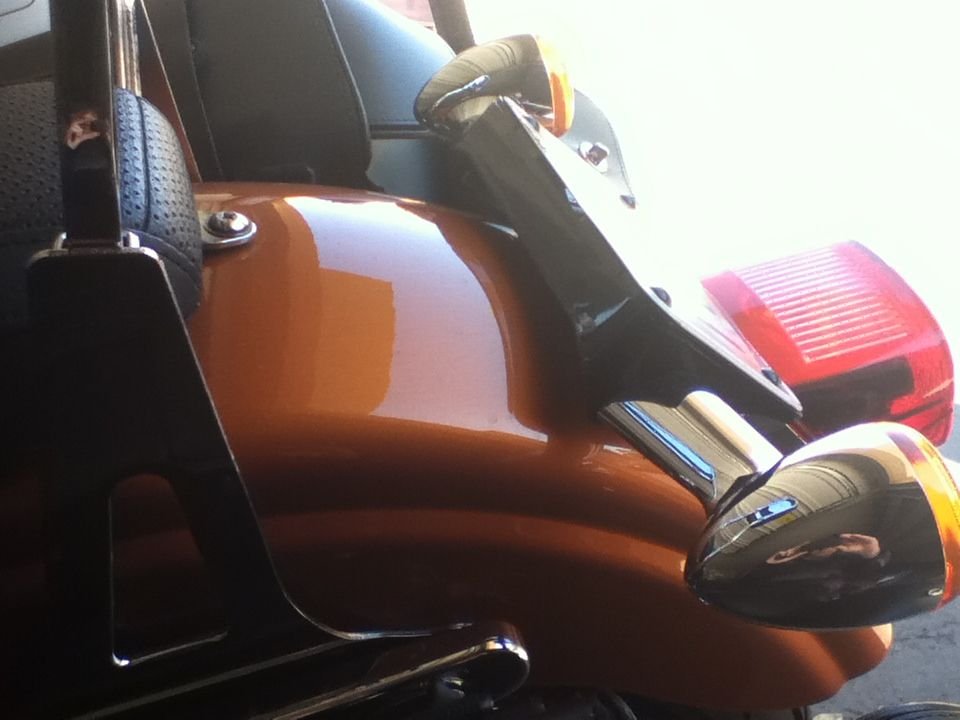

I wonder looking at them if the bags have a large gap between the bike and the bags. s. I had US Saddle Bags and they held up well for 8 years on a Yamaha.

There is a gap. I don't have pictures of them on my old Sporty, but here are the ones I just put on the Dyna. I reckon the fit would look similar on your bike since the fenders are alike. And for good measure, there's also one of the turn signal kit. I chose black because I like the contrast between that and the chrome.
