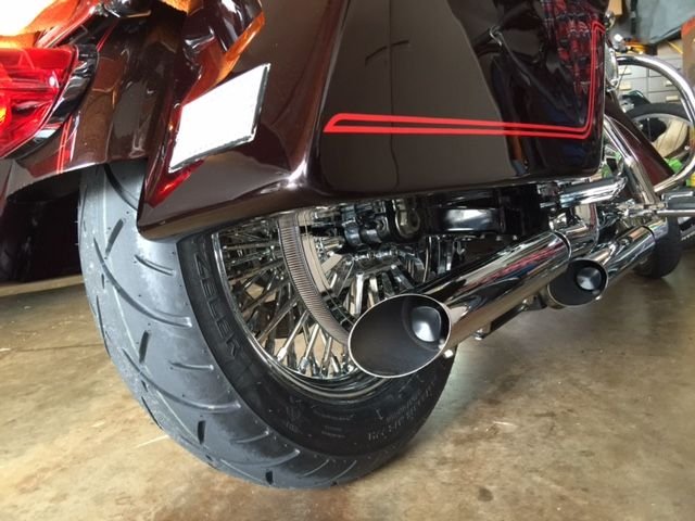

These are W158s TTI in a 3" OD slip on with 2" baffles.

If you are wanting to cut down on the popping, maintain the current sound(just a little deeper), and relatively similar power band... I would suggest the 118 series. As you can see in hscic's very clean install photo, the TTI can be installed at the opening of the baffle itself
