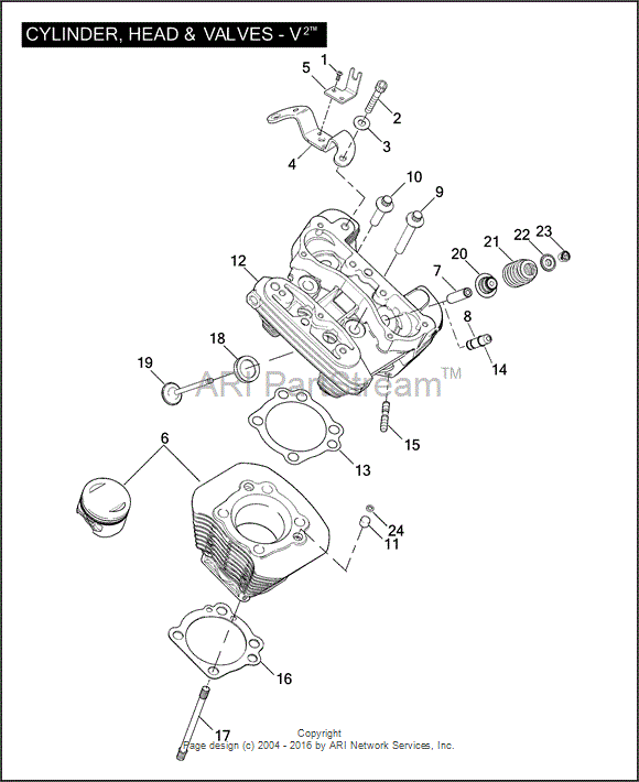

Quick one for the pros:
I bought one of those choke plates from CV performance to move the enricher. Well, I figured since there's nothing there, I'll just remove the bracket that was holding it in place at the stock location (see part #4, HD part number 16353-04):
Is this an essential bracket? I don't want to leave it off if it needs to be there.
thanks for your help

Those holes are just plugged with a bolt on the fuel injected models so I'm sure you could do the same.

serves no purpose other than horn mounting on efi bikes

Isn't 4 important? 5 you can remove but the cylinder head to cylinder head one?

No #4 is not required, it's only there to mount the choke and/or the horn.
Many models including mine came with no bracket from the factory, mine has no choke and my horn is mounted in the front down tubes.
#4 not present

On your new rubber mounted doo-dads this part isn't required. On the older hard mounts like mine, this part is actually one of the motor mounts.
