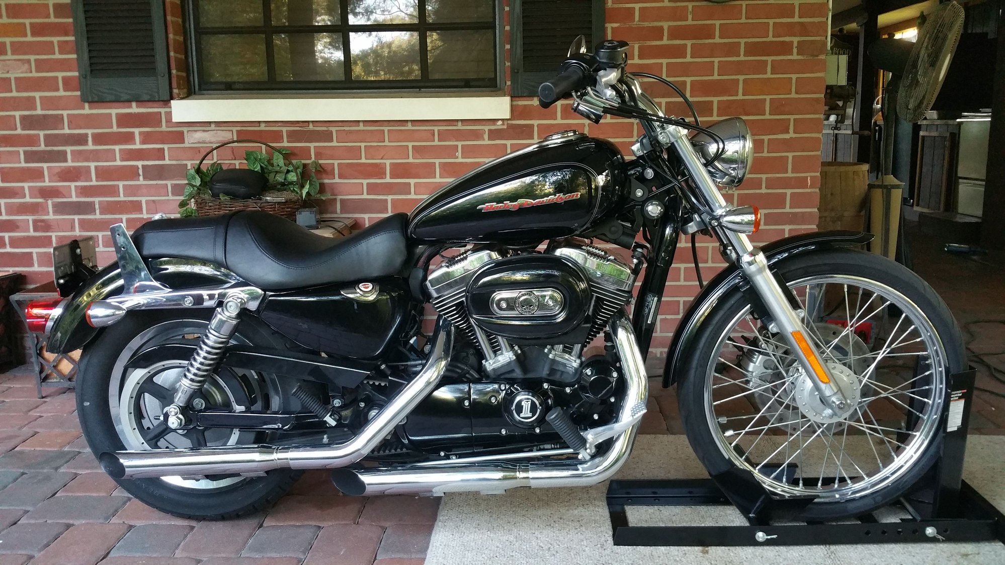

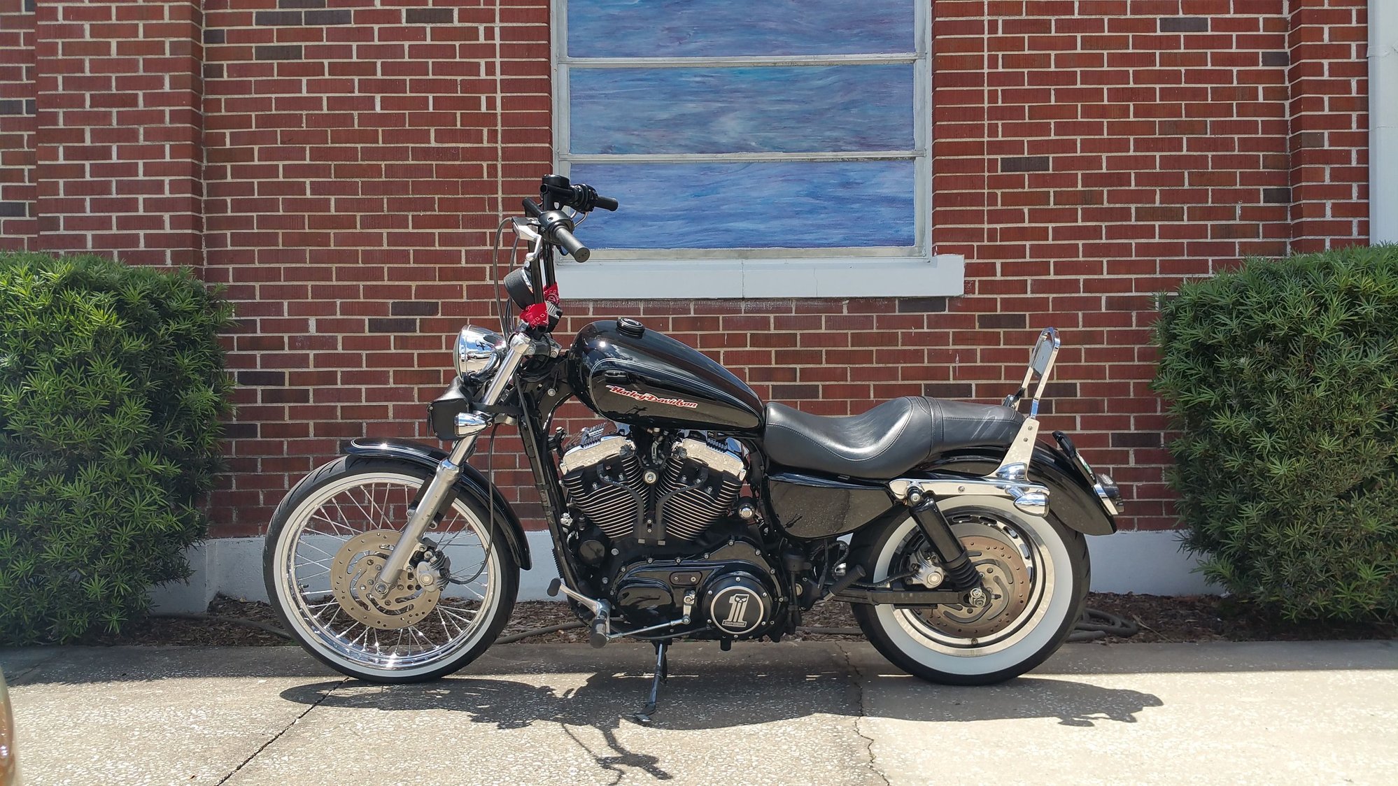

The day I picked her up from a Craigslist deal. She had just a hair over 6k miles when she became mine:
Current progress (for now):

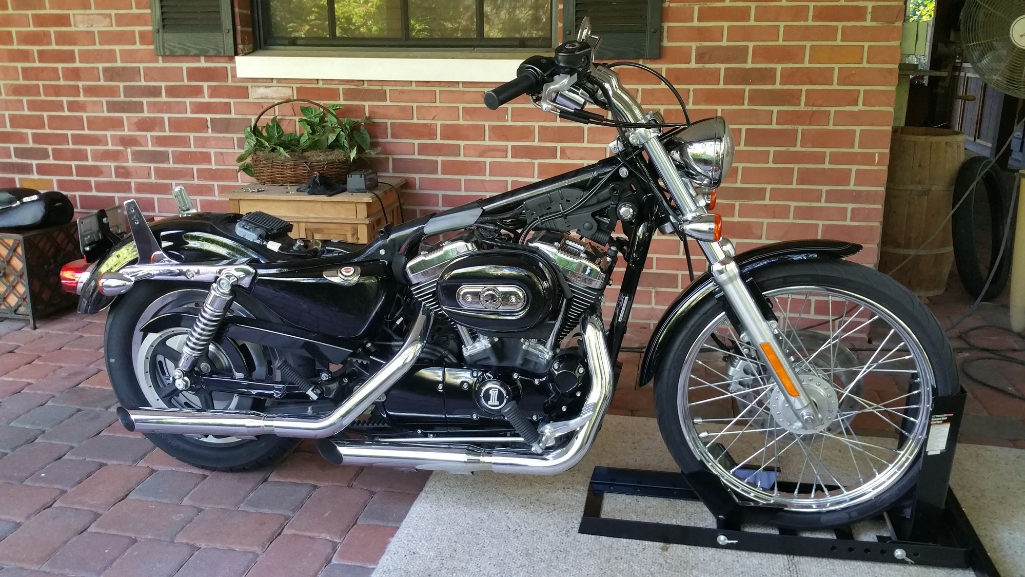

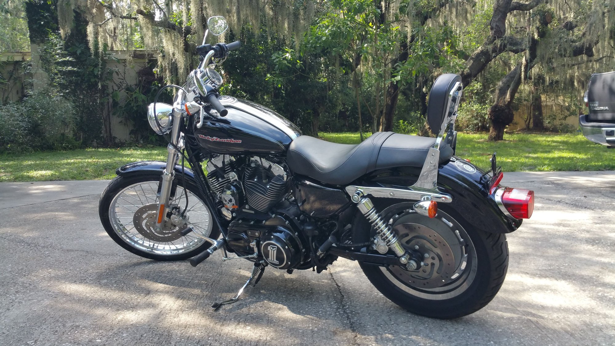

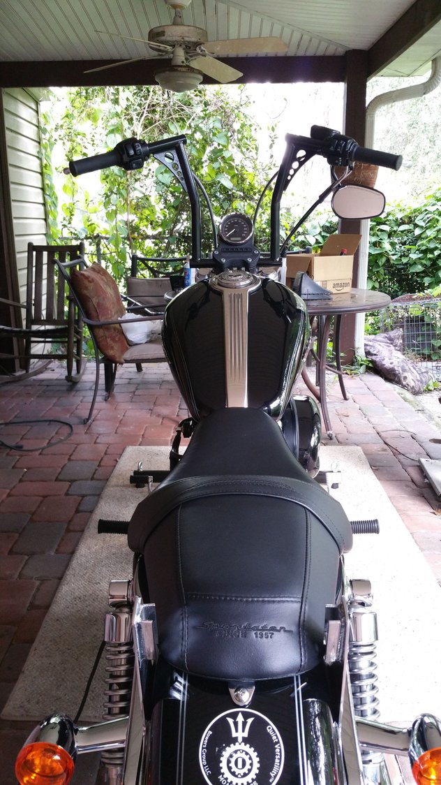

Next up was swapping the stock bars/riser combo for Road 6 Customs 12" ape hangers and a Nightster/Iron speedo mount. I also decided to go with a 2" tank lift and ignition/coil relocation from DK Customs for a clean, classic look.
I've always like the way apes looked aesthetically, and after a few months of riding with the stock bars/riser, I found that I wanted to swap them for the comfort aspect as well. For never having owned a bike and not really doing much to the bike before this mod, this was quite an undertaking for me; however, the outcome was pretty much exactly what I was wanting - perfect height at shoulders and a more relaxed position for my back when riding. The bars and stance look killer and it all really helped me execute my vision for progressively blacking out the bike. The ignition/coil relocation w/ the wire tuck also really helped clean up the look of the bike.
Here are the before and after photos, but you can find the entire documented process in this thread here ----> https://www.hdforums.com/forum/sport...tips-pics.html

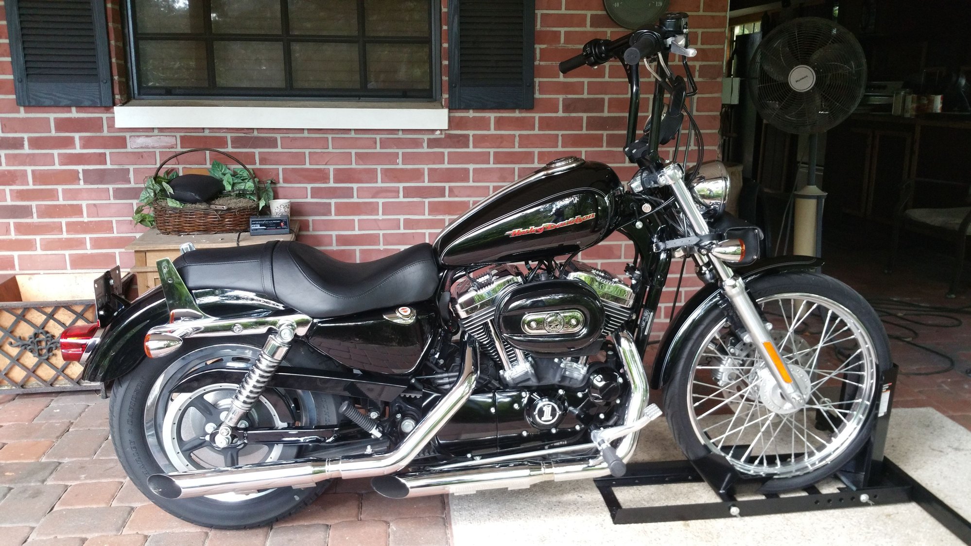

The way I bought her
Before: rear view
Tank off with crap factory plastic and ignition and coil in stock location
New bars, tank lift, coil/ignition relocation
After: rear view

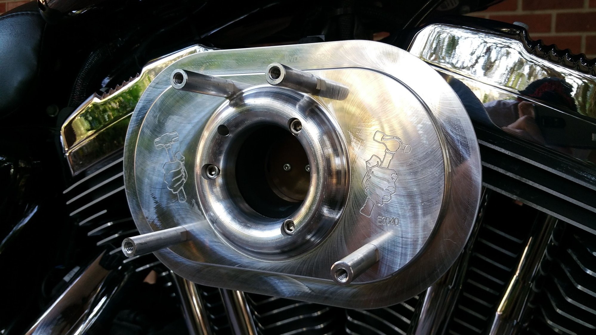

Next up was the intake. Got sick of the crappy stock air cleaner that had the engine breathing hot oily air back into the intake, so I decided I needed to switch to a more effective setup. I had heard tons of good things about the guys over at Hammer Performance and they have impressive dyno proven results to show for their work. Most people go with whatever looks the coolest on their bike - to each his own. But that's not me. I was looking for the best performance results, and I was very impressed with Hammer's line of air cleaners and I chose the Impact.
Here you can see the top notch machining done to the backing plate. The radius "hump" at the mouth of the intake smooths airflow as it enters the intake, resulting in smoother delivery of air to the engine. I now run this with the stock air cleaner cover, which I actually don't mind. Heck, I even like the look, to be honest.

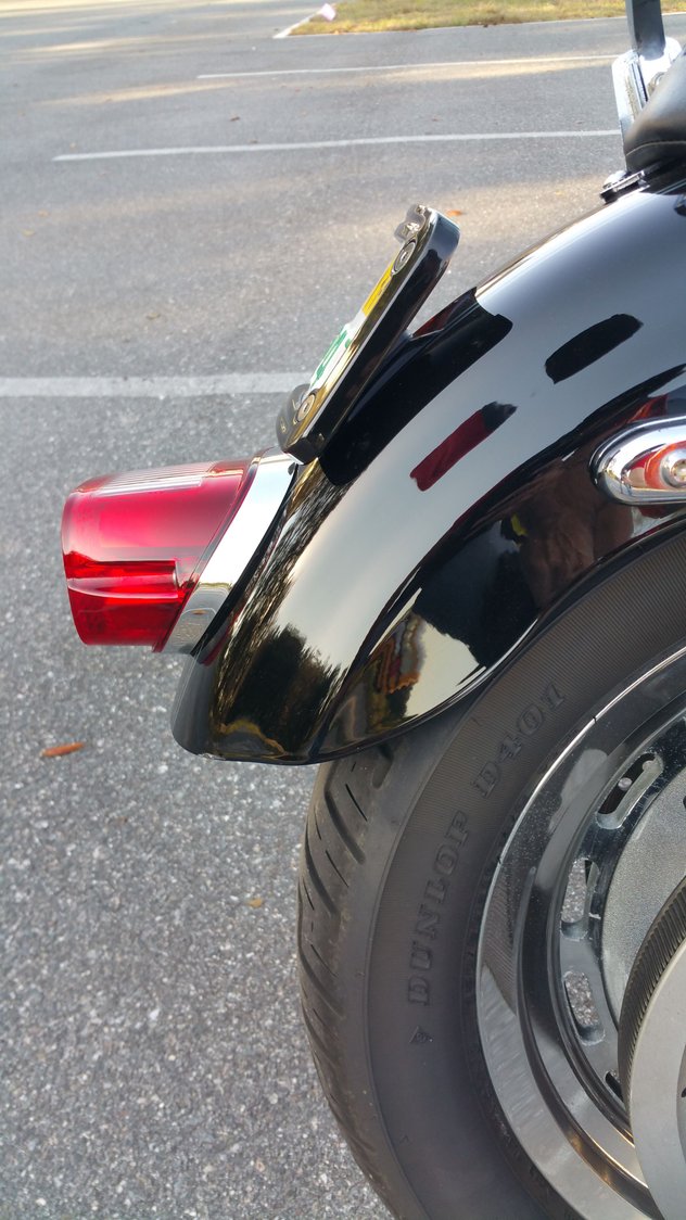

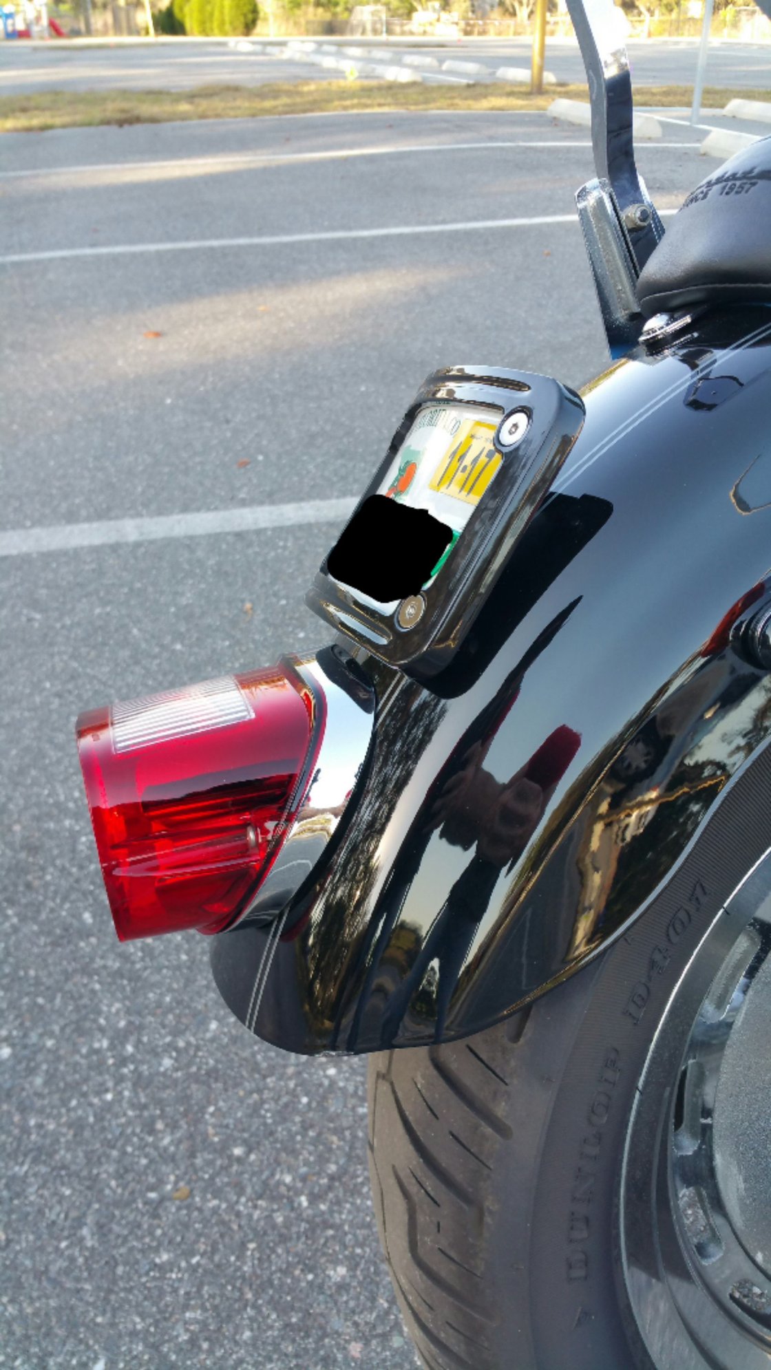

I always disliked the way the stock plate mount stuck up like a sore thumb, so I decided to do somethin about it to clean up the bike's appearance. I browsed a lot of styles for a while and considered side mount license plate brackets, but I just didn't like the (mostly) ugly options available for filling the holes that would be left behind from the old mount on the fender. Since I decided to keep the old mounting location, I chose to do this Milwaukee Twins curved plate mount (JP Cycles). I'm really pleased with it. It's gloss black so it blends well with the bike, and it's curved and laid down to hug the lines of the fender. It also has a rubber mounting pad to go between the fender and the mount, which was a must for me. No more paint abrasion. Now to do something about that massive eyesore of a tail light...
