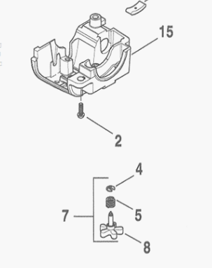

Are you sure? I do not see any 883R model for 2016. Anyhow, just to humor me, can you make sure that the star-shaped screw labeled 8 in the diagram below is not tightened:

Originally Posted by Oddman
have the cables been lubed? is your cruise **** dragging? what year is this?
+1, dont know its real name but had the same symptoms and didnt know it was that star shaped throttle **** cruise resistance thingamabobber hanging up my throttle
