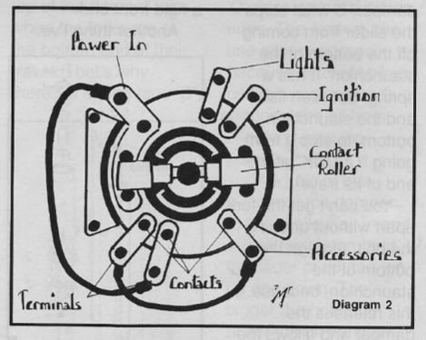

If that switch is like mine the diagram is wrong. the RED is on the wrong terminal.
It should be on the terminal located at the 1 o'clock position.
The other 2 with the jumper at 11 and 10 o'clock positions.
Keep in mind this is looking from the BACK, UPSIDE DOWN AND FLIPPED.
Like you turned it over in your hand to look from the bottom.

Plus your picture shows the ignition in the ACC position.
With it being wired wrong and in the ACC position you're getting voltage everywhere.
