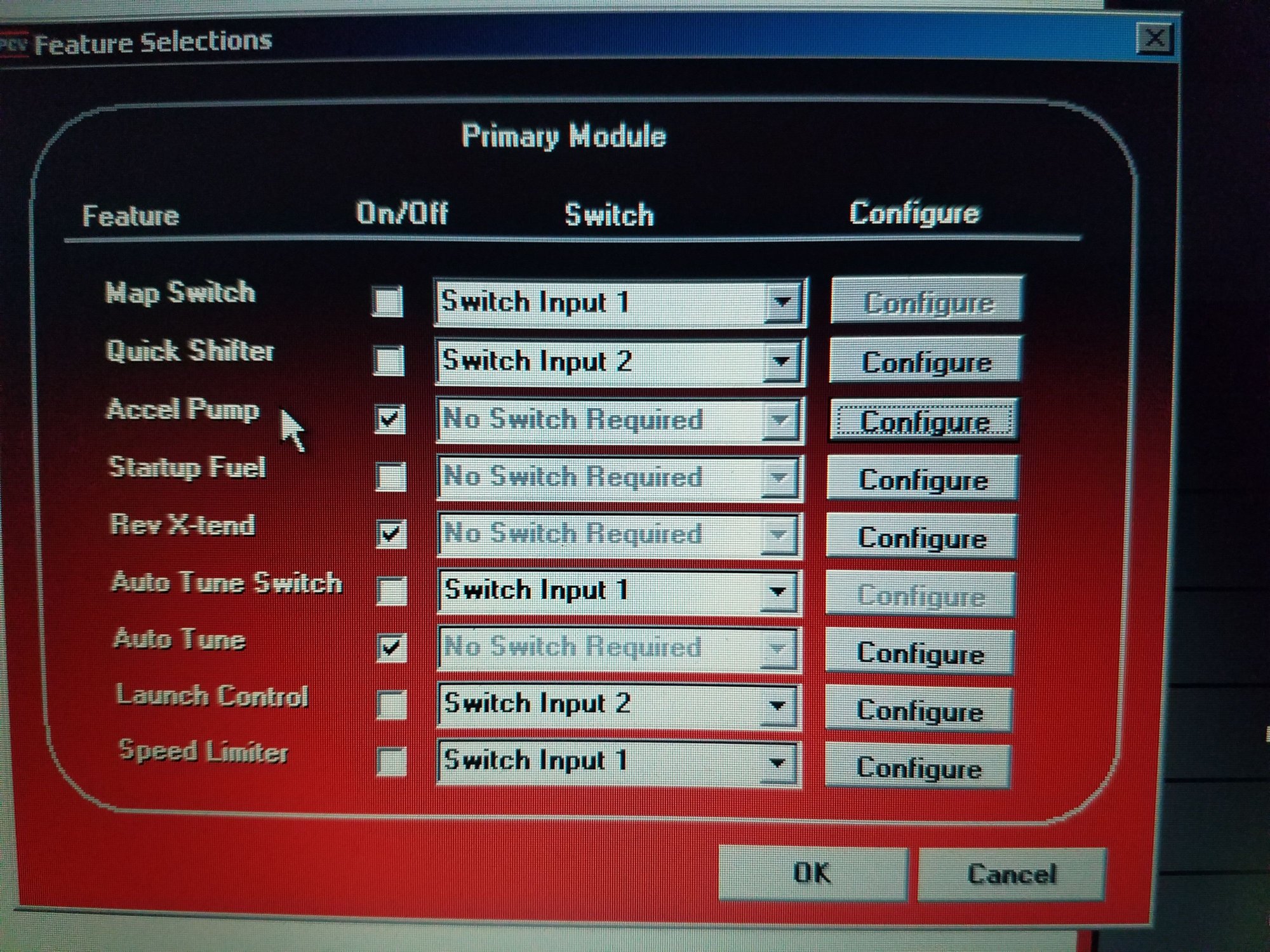

Cool Too Lean ..???
You might try to increase the accelerator pump volume about 5%....should be better of idle and quicker when jumping in the throttle at speed ...
click configure , increase duration for 3 rev's and amount by 5% ...(take picture of setting before making changes ...just in case)
hope this helps ..
