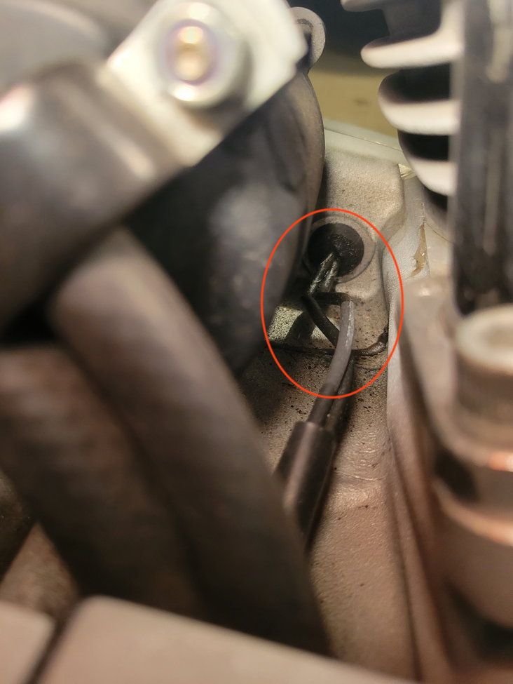

I started diving into the issue of my recently acquired bike and I figured out most of the except this one:
It was diagnosed by the previous owner that there's a leak from the "Stator Plug". I don't know if that's a thing really... By plug I assume they meant the wires? But there's no oil there.
I'd appreciate some thoughts here

ever mind... I think I found it. Question can the rubber piece (plug) be fixed somehow from the outside? Or can it be replaced? I can't find anything on the web except replacing the whole stator.

Does not look like it's leaking to me. Keep looking. Have you checked the hoses to the oil pump?

I updated the picture above with a red circle. So you don't think that's a leak? I mean it seems very minor but it's still oily and stuff

You can try a high temp gasket sealer from the outside
But you might have to pull it and seal it from the inside.

IDK, doesn't look like it's leaking enough to leave the spots you're seeing on the cardboard. I would think a leak there would migrate to the right side of the engine to the sprocket side, not toward the back. Any oil up there inside the primary case is just splashed so when engine off it should not have any oil splashing on it.
John
I see what you mean. And I agree it shouldn't be the reason for that dripping towards the rear of the engine. That one I believe it's from the drain hose.
But this one - the stator plug "leak" looks like some minor leak and I'll most likely leave it alone.
