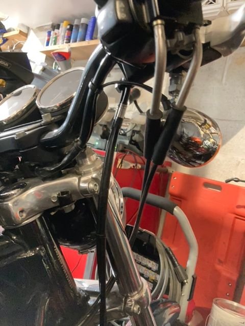

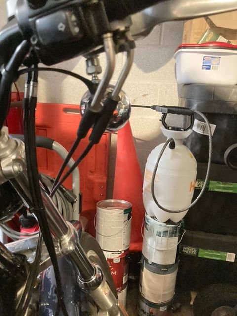

OK, so I was changing the intake seals to hopefully fix a rear cyl cough. And one of the throttle cables broke, inside cable rusted right in the middle and separated. No problem I said, but it's a 2000 1200C and dealer said those cables no longer available but they could get compatible ones.
I figured if they going aftermarket I can just do that myself got some on ebay $19 for the pair. But they are sticky, wont come back on their own. NOT what i want. If the retirn cable fails I want the carb spring to take care of closing the throttle.
One thing, even with the cable's adjusters all the way in, I still had to take the bracket off the carb to get the ends all on, but that was just 2 screws, easy.
There are no sharp bends (tank is even still off). So is there a source for GOOD cables with the proper size ends up at the hand throttle etc? (I dont think thats the problem but hey who knows). Throttle friction adjust is all the way out.
any cable sources advice appreciated, basically who makes a good cable set hopefully in 36"
I wanna ride this thing this year!
Thanks

You may want to check the orientation of the cable guides coming out of the throttle, they do not look to be the correct way and causing some of the issue.
Pics of the way they are orientated on my XLH2003S are below for reference.

Originally Posted by sportsterchris
thanks guys all good advice.
the XLH1200C have a 90 degree bend at the handlebar end, and about 36" long (black part).
Yes they have a 90 degree bend; however, they should not be facing forward as in your pic, they orientate to the side toward the frame inline with the handlebars.
