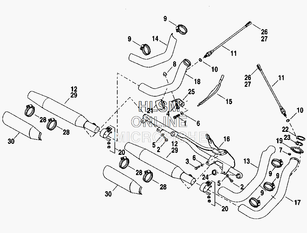

As stated above, that is the inner heat shield, it could be there to protect the rubber oil hoses from the heat of the exhaust pipe. The shield is item number 15 in the parts diagram below.

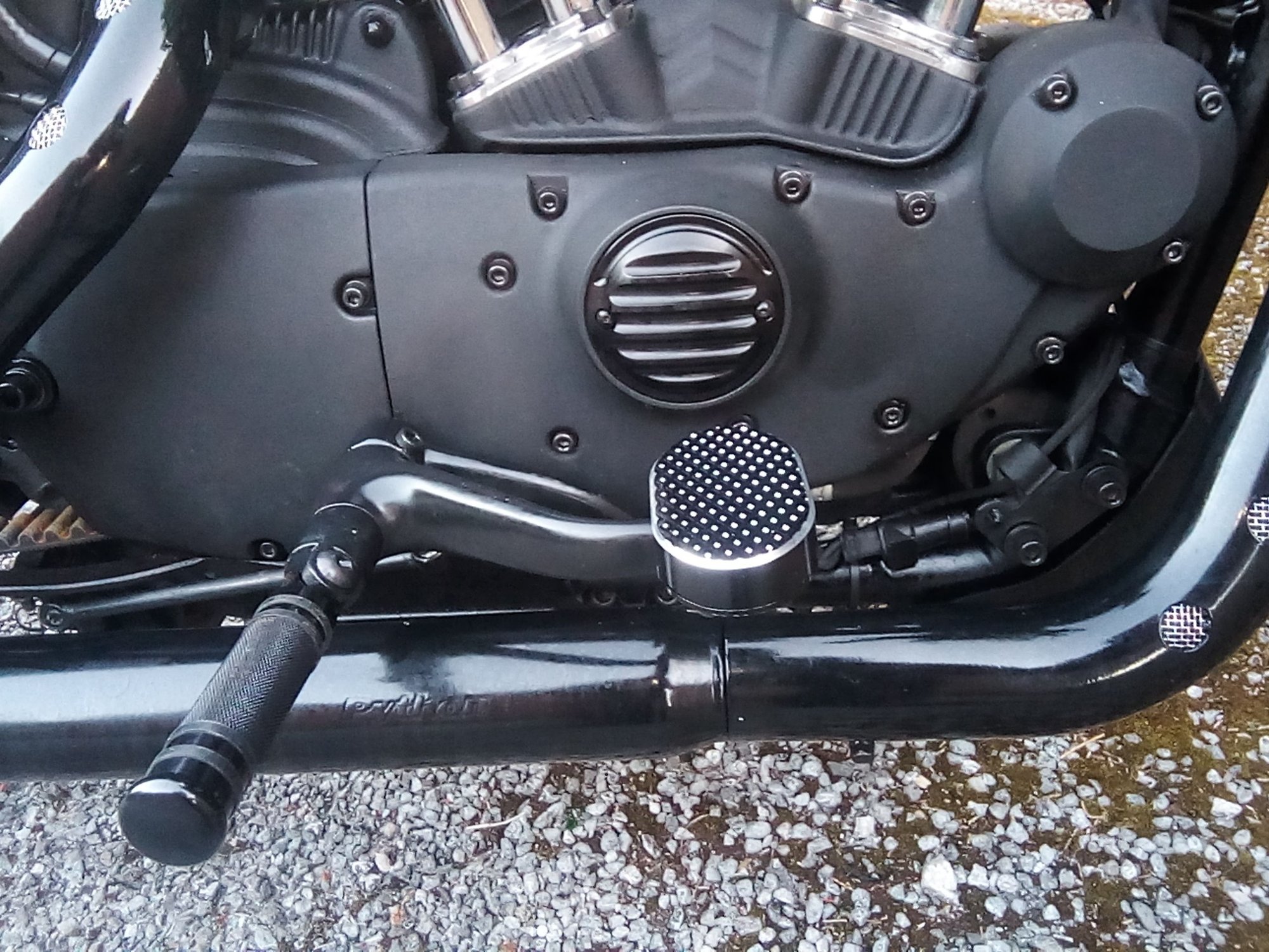

I also removed my inner heat shield because I installed a starter motor cover on my 2011 Iron 883, the cover protects the oil hoses from the heat, so the stock heat shield became superfluous to my requirements. See the photograph below.
