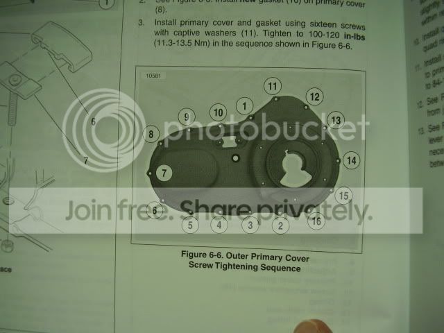

from 2004 XL manual
100-120 in-lbs
there's a tightening sequence

Originally Posted by HarleyScuba
from 2004 XL manual
100-120 in-lbs
Just take notice INCH POUNDS.....NOT FOOT POUNDS

here it is in FT lbs
8.3 --9.9 FT lbs
8.3 --9.9 FT lbs
Not to be a smarta$$, but where do you find a foot pounds torque wrench, calibrated in 1/10 pound increments?
Torque wrenches are the most accurate in the center of their range and I've yet to see a foot pounds torque wrench where less than 10 pounds isn't off the bottom end of the scale.
Done correctly, you would use an Inch Pounds torque wrench with a range of something on the order of 20 - 200+ Inch Pounds.
