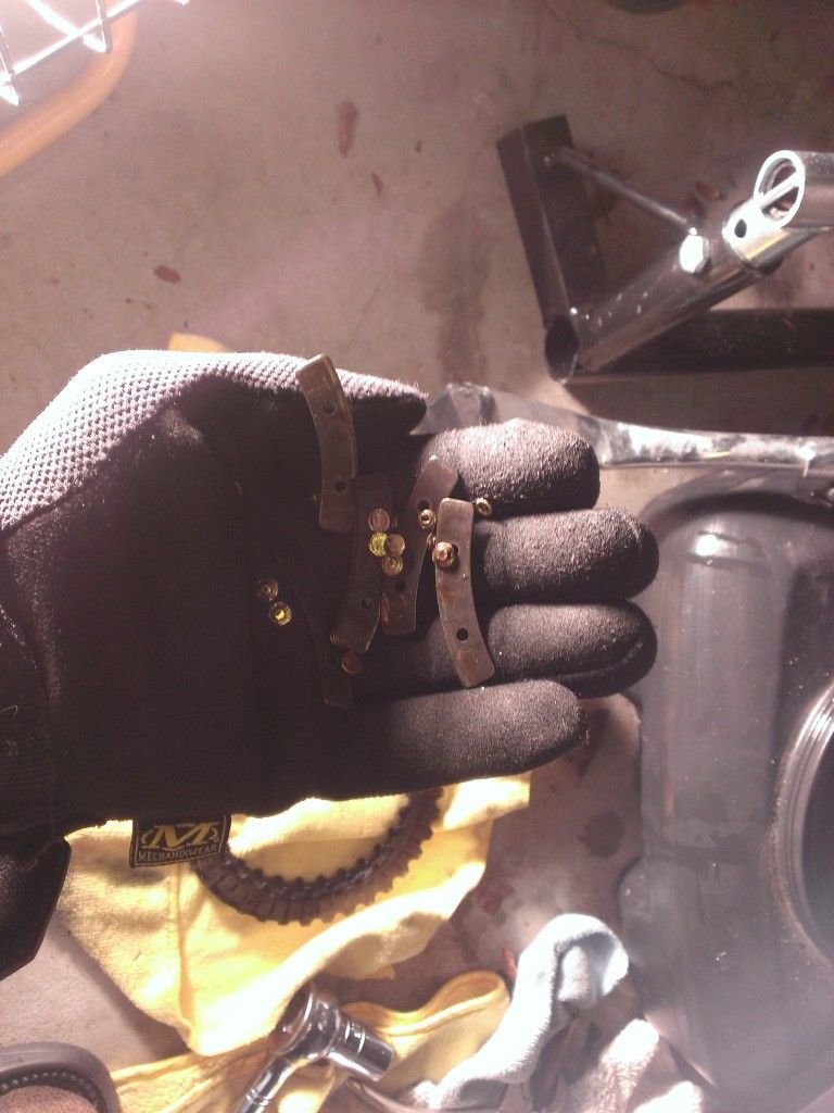

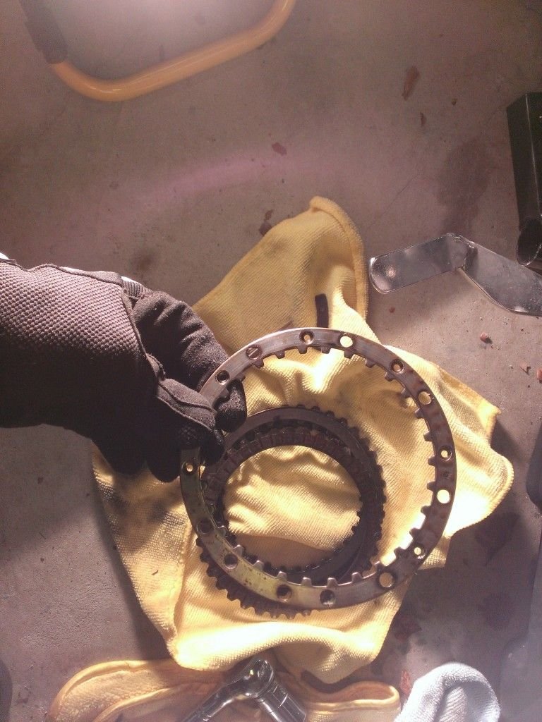

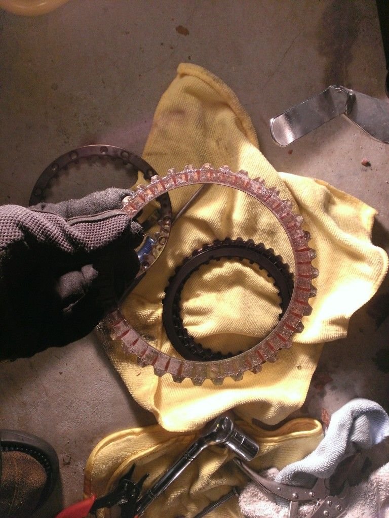

Well, sure as S#!/ that spring plate blew its rivets all over the clutch basket. I am still pulling plates out trying to make sure I am inspecting well as I go. Some photo entertainment for y'all:
Clutch basket with shelled out spring plate rivets in the grooves.<br/>
Spring plate. Missing something? Rivets!
Here they are!
And the shell out smoked the friction disks on either side of the spring plate! The rest were pretty good.
