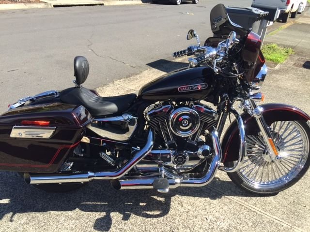

It depends on the type of riding you will be doing. It's not good nor bad...it does what it is intended to do - lower the bike.
I have the burly slammers kit installed (10.5" shocks and lowering fork springs) on by sporty bagger...not much difference in ride from stock. My intent was to lower the bike as much as I can without bottoming out and hindering the the ride i.e. low-profile sporty bagger. It rides fine but if you do hard cornering, you may/will scrape. I do not go on long touring-type rides so it suits my purposes and allows me to plant both feet. Just watch your right side fender bolts so it does not touch your tire...left side had ample clearance. You also may need to install a shorter kickstand if your bike sits too upright.
If comfort is needed, then suggest you go the lowering blocks/better shocks route. If I had to do it again, probably would go with Progessive shocks and lowering blocks....best of both worlds. Still need to watch for clearance...since this will only give you more travel and better comfort. Keep in mind, your seat also is a factor when it come to comfort and height. For me, that backrest made a world of difference....but I am old so need the back support lol.

I have burly slammer kit (shocks and fork springs). Lowers it nicely...1" for me on my XL1200L from 11.5 to 10.5. Not good nor bad...it's okay but my objective was to slam my bike and to make sure I could plan both feet. Had to change kickstand to 1" under. As mentioned, you also can not rip the turns unless you don't care about your kickstand or exhaust. Your seat also affects comfort and height so it is not only suspension that you should be thinking about.
If you want comfort, get air shocks or something similar and use DK Customs shock lowering kit....
