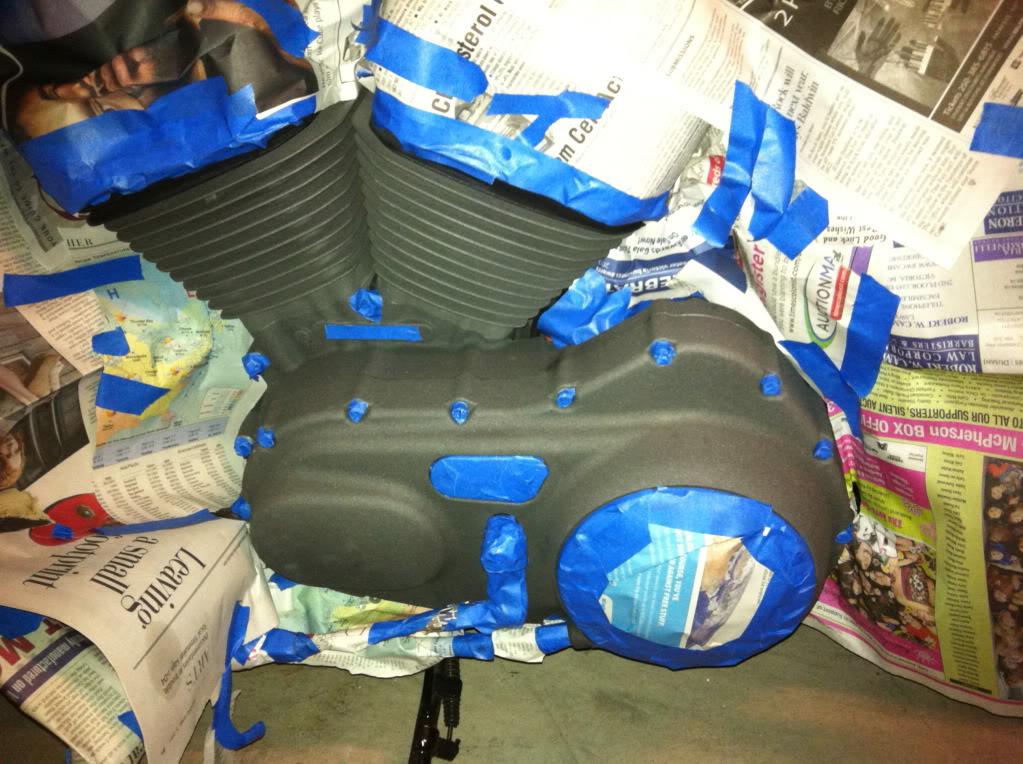

oh yeah i didnt remove anything hence the taping time...

Hmm, looks pretty neat, but why did you spray it gloss on one side and matt on the other? Care to post how does the right side of the bike looks like?

I used the VHT header paint in flat black. I done the same as Jaysomethin. Tape everything you don't want painted and just paint. I didn't wash my engine off with some degreaser cleaner first to make sure there were no oils. Drinking straws if they fit good would be a good idea and I have read a guy used those little black plastic caps like the ones that are covering some of the bolts on the bike now. I didn't prime anything. I already had tape and paper so the project only cost me $8. Just remember after a coat wait for however long the can says to dry and then repaint. One can was enough for me to paint the whole engine with two coats. Let your engine idle after your done to bake on the paint if you get the VHT header paint.

sorry heres the pics of the finished job... both sides, came out real smooth, that gloss look died right out and has a nice wrinkle black matte finish..
