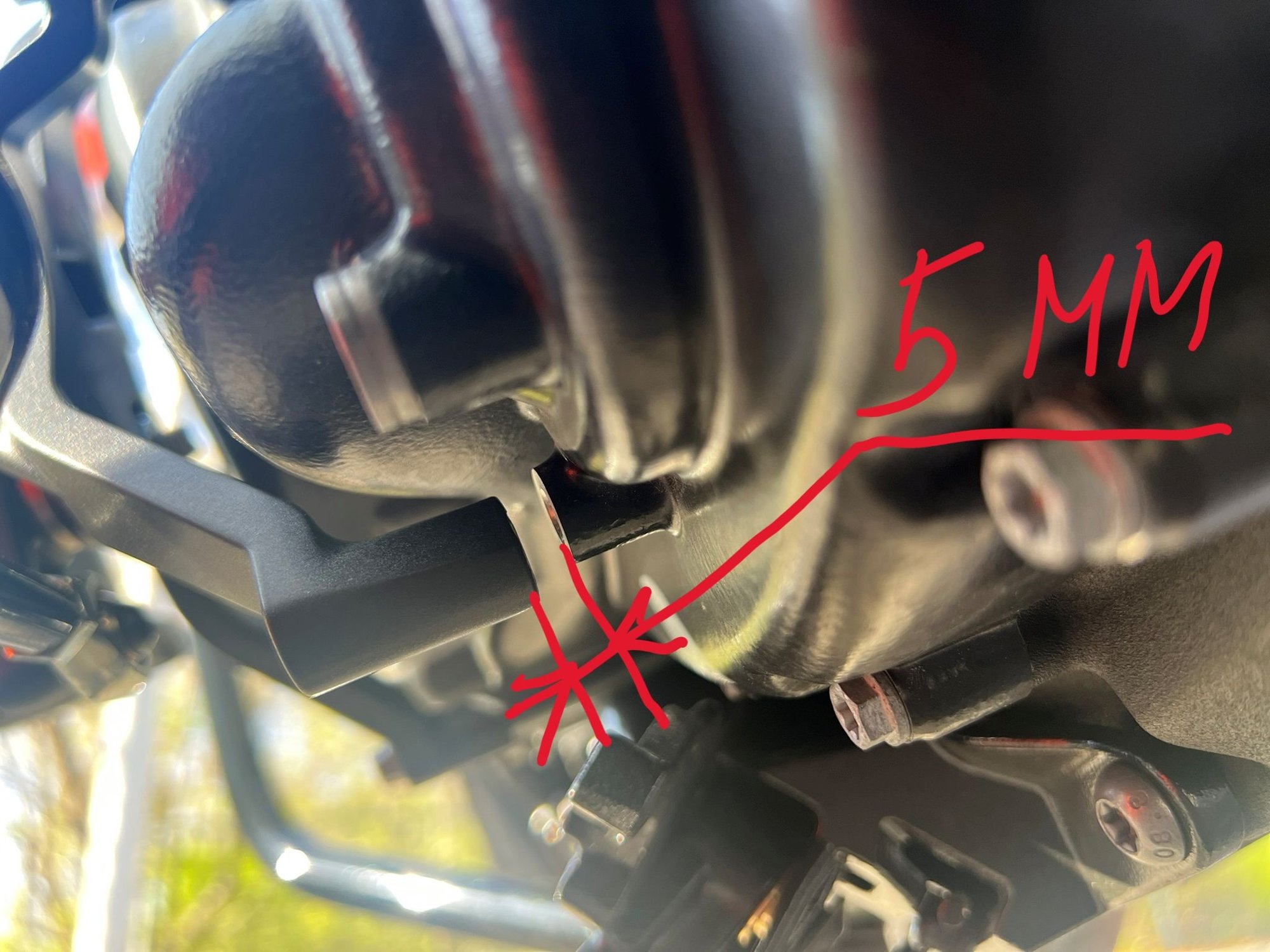

Today I put a set and found that the left lower mount of one leg has a gap of 5mm, and if you tighten it without a spacer, you can break the mount. be careful
point #3 on diagram.
P.S. Tomorrow I will install in this place 3 stainless steel washers for the M6 bolt and 1.5mm thick each (4.5mm in total)

My mistake, when I started to put the plastic, I discovered that the plastic lining gets into this gap.
