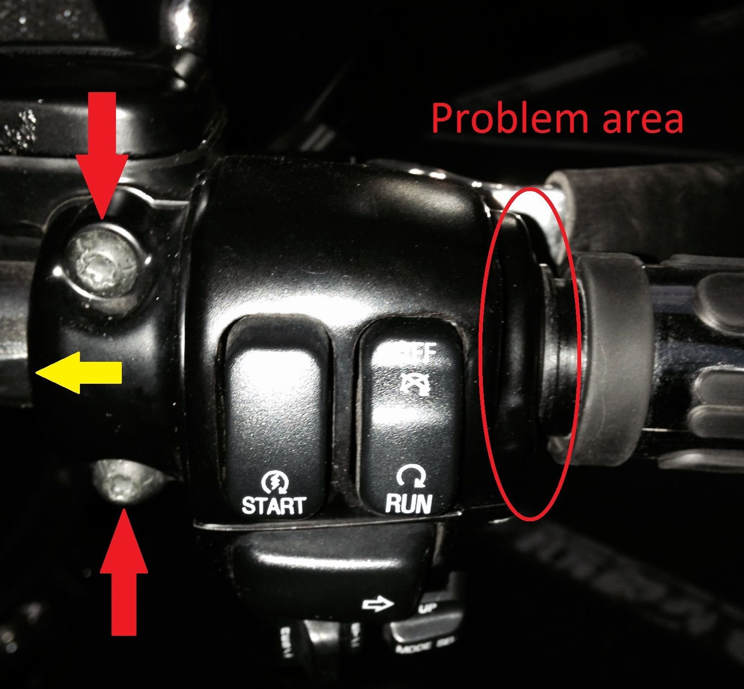

Problem solved! I just loosened the two screws keeping the control housing and slide the whole housing slightly to the left. Took a picture of it so everyone get what I am trying to explain. Thank's again for your help.

Throttle problem Problem solved! I just loosened the two screws keeping the control housing and slide the whole housing slightly to the left. Took a picture of it so everyone get what I am trying to explain. Thank's again for your help.
Yep exactly what I was trying to explain. Glad you got it figured out.

Originally Posted by Tolper
I took my 09 Ultra out for ride yesterday, was riding on I-95 down south in heavy traffic when all the sudden I had no throttle. It died on me in the middle of the highway and I was almost run over by a truck!
I managed to get it on the side of the road, engine was idling and throttle handle was spinning freely! I noticed that there was a small gap between the throttle and the frame so when pushing the handle in "left direction" it started working again, but spinning freely when releasing it. I managed to get home by keeping it together with the force of my thumb.
This bike has the electronic throttle control that I am not use to. Do I have to replace something or is it possible to tighten the throttle handle in some way?
Bike has only 8000 miles.
