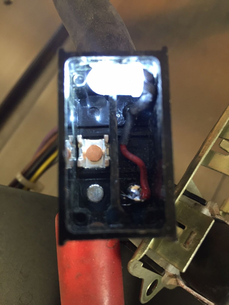

Well I pulled the switch panel and unplugged it from the harness. Then I pulled the switch from the panel, hooked leads directly to it and a 12V power source to rule out a bad ground. The lamp would light intermittently when I flicked the switch with my finger. I then opened up the switch housing and saw that it has a small regular incandescent bulb in it. I figured the filament was broken and would make contact occasionally when I flicked it with my finger which makes sense why it would only light once and a while. I went and tried to find some white 12V 5mm LED's today, but this being Montana with limited electronics stores I wasn't able to find any, so I ordered some of these off ebay and should have them in a few days. http://www.ebay.com/itm/261817014106 I'll give them a shot when they get here. Some may asked why I don't just buy a new switch from moco, well at about $35 each I'd figure I'd try to fix it first. Here's a photo that shows the inside of the switch (minus the innards) except for the lamp in the upper right hand corner, the leads for the lamp come off the two copper contacts on the right hand side. Once I receive the LED's and get them installed I'll be sure to update this thread to let everyone know how things turned out.

Here's the follow up to my thread, I got the LED's today and got it installed. Here's some photos of the install, the first one is testing it after I got it soldered inside the switch. As you'll see the light looks good and is equal in brightness to the others. Time well tell on how well my repair holds up.
This photo is after I got the switch reassembled and testing it
