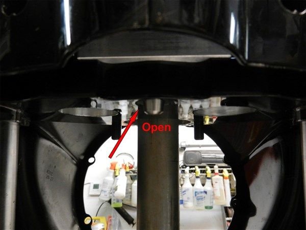

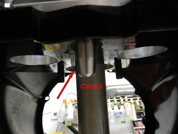

Default Finished last night
Lock modification was very easy after making a new Stainless Steel replacement bolt. I just replace it by removing the two screws under the lock and pulling the pin than installing the new bolt & reassembling it. I did my own the day before yesterday (Tuesday, 1.26.16) but I am slammed at work building stuff no one else knows how to do on other projects. I will ship these parts out to Greg & one other customer who has a 2002 Road King with (I believe) a 145ci. There are so many HD models and HD makes so many different minor changes, actual real life testing is needed before the release of any new product is necessary.
I designed these trees to also be used on inverted forks if anyone actually wants them. These will work out of the box. I am getting a patent for this set up to eliminate those unscrupulous people who copy my design and ideas. Please remember that I started this project many years before HD announced their 49mm forks in the 2014 Touring family.
