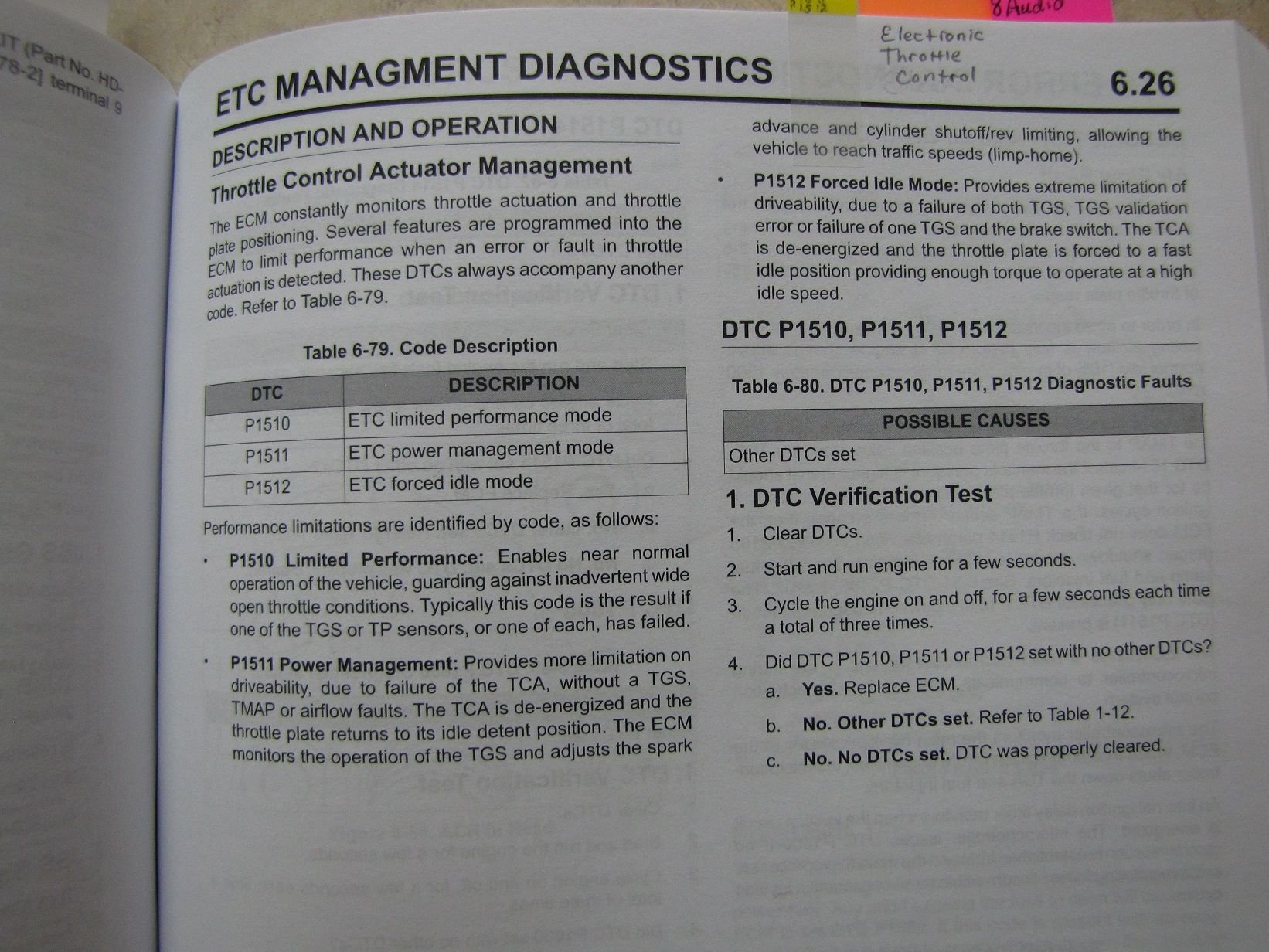

The many faces of Limp Mode:

Thanks Vernal, the limited performance sounds like what he described. It would still run at highway speeds but took a while to get up to them. I have the bike now and will pull the codes tomorrow.

Great info from Vernal (as usual). I forgot about all the variations being caught up on what others call those symptoms typically.
Since this happened right after a bump, a good place to start looking is the TCA connector. In the past it was a common issue. Fretting, water, corrosion and stuff. May only need cleaning. Lots of threads describing that issue.
