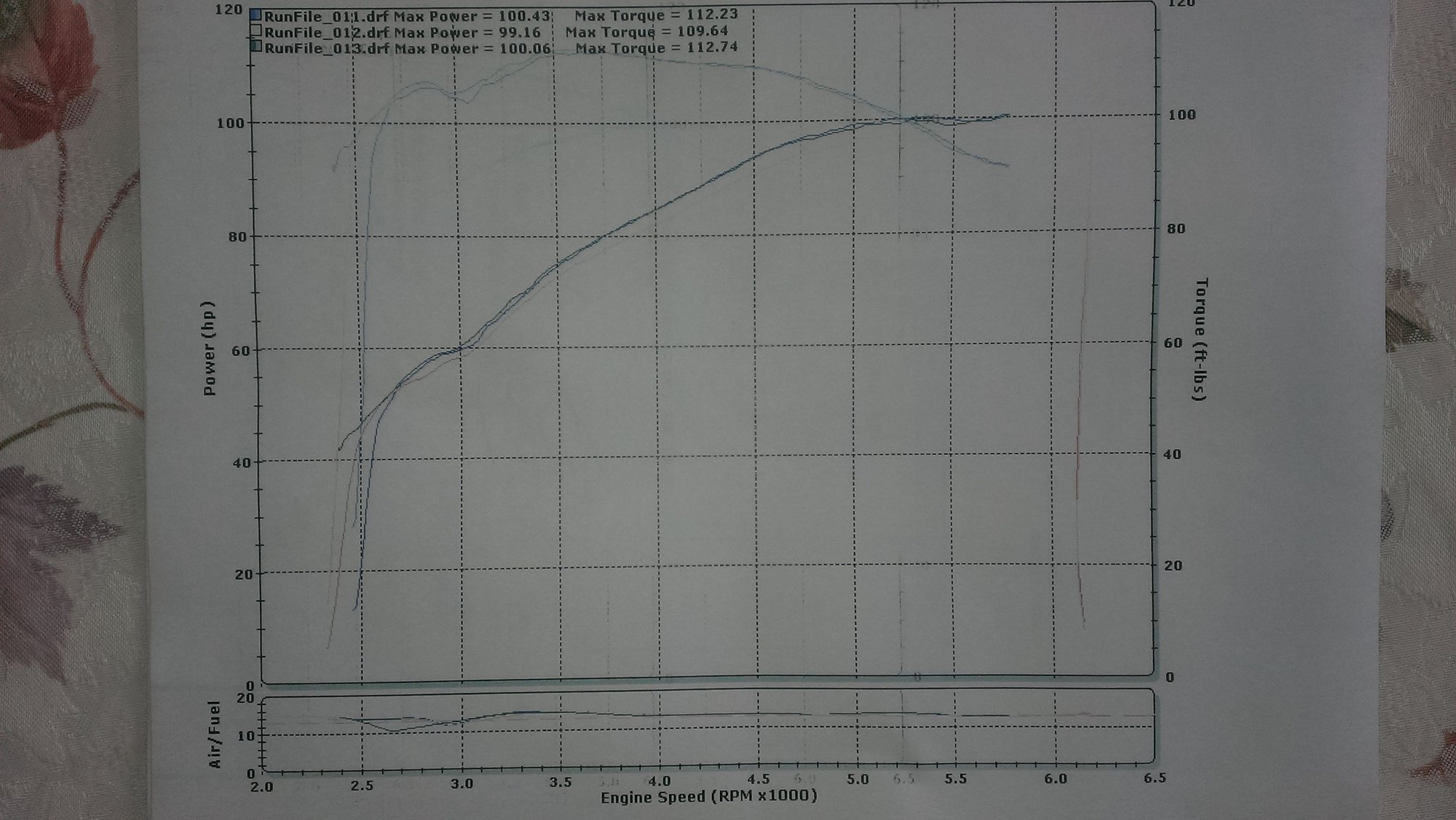

2012 103"
Open a/c
555torqster cam
Stage 1.5 heads
Stock decatted head pipe.
S.E. slip ons.
Looks like 100h/p112tq not a fan of the dip. Was looking for 105/115. Oh well....lol!

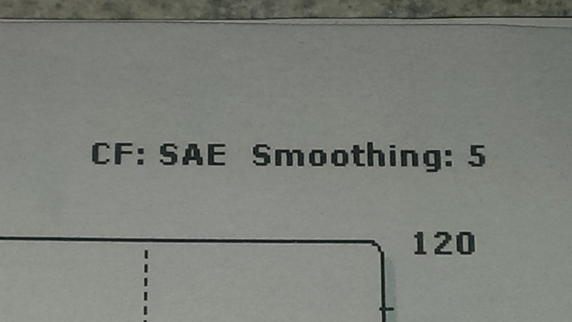

The top and bottom of the sheet are cropped. That's usually done to hide the smoothing factor. Is this SAE or STD? I would've expected a touch more with the head work.

Here ya go.

Wasn't bashing. Was just curious because they look a little low to me. But that could be reflected by the extent of headwork that was done as well. Regardless I think you'll find the bike has a bit more spunk to it.

Lol! I wasn't Accusing you guys! Mostly posting for others. And waiting for someone to explain the dip where no one wants one. Lol.
Long story short......I have nasty s.e. slip ons. Couldn't move fast enough to see if a better set would have made a difference. Kinda glad I didn't get them.
I don't want to waste money on slip ons, if it won't take care of dip. Maybe 2/1?

Don't under estimate the effect slip ons have on HP and TQ. A badly designed set of slip-ons can kill power all by themselves. Generally speaking, a good 2-1 is as good as you can get power wise, particularly for low and mid range.
