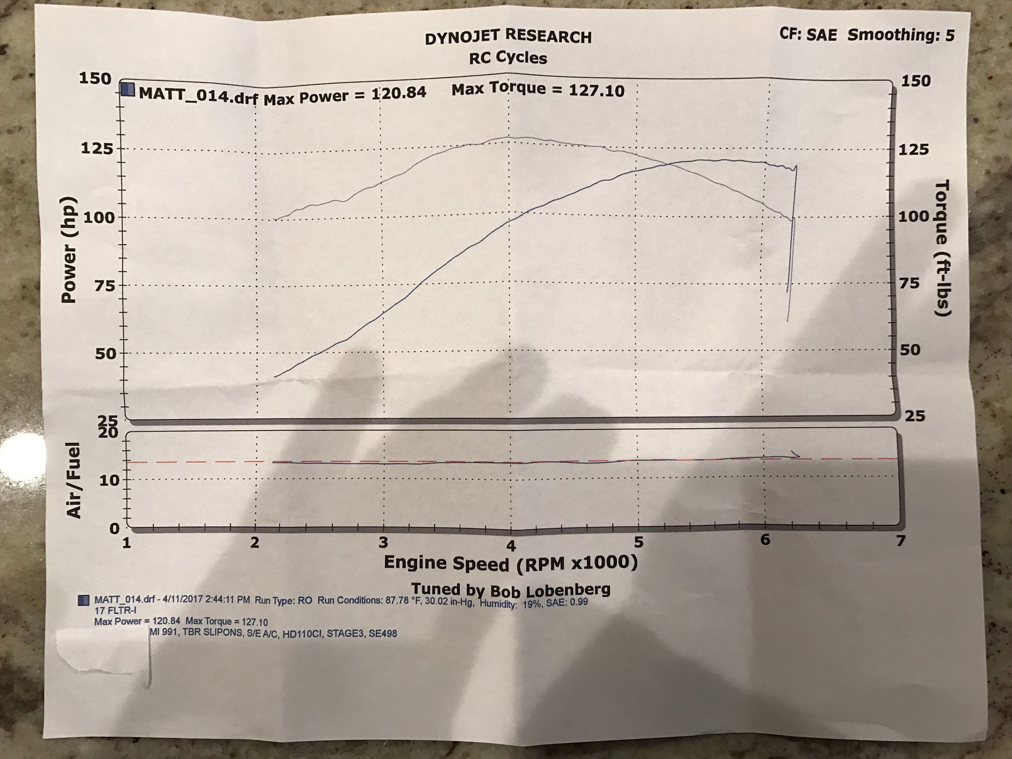

Here's there dyno sheet...enjoy...

Excellent power and great HP numbers. My only concern is where these numbers are achieved, alot of us don't want that 4500-5500 range of power. Although what a great passing traffic formula. Keep up the great work Jamie.

I don't think you have to worry about that. look at that torque curve, it's almost instantly over 110 ft/lb, over 120 ft/lb at just over 3k rpm, and stays there until just after 5k. i'm betting that that bike is a real fun ride
