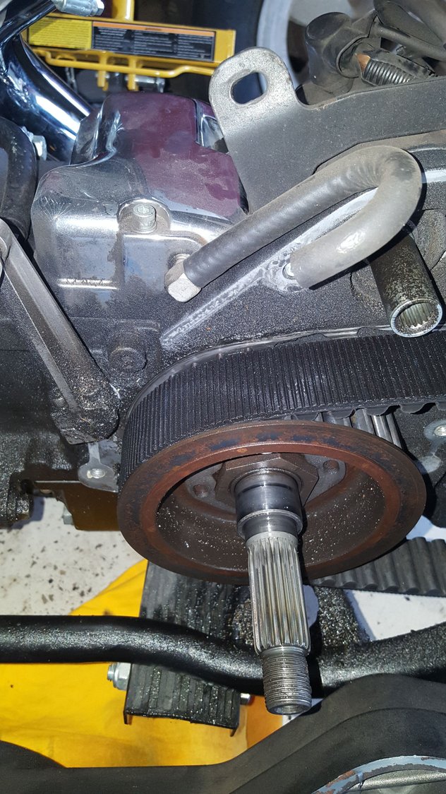

@!#$%& I cannot get that jackshaft bolt off. Can't BELIEVE how tight that thing is. WTF?

Use a impact driver on it.

Finally! geez!

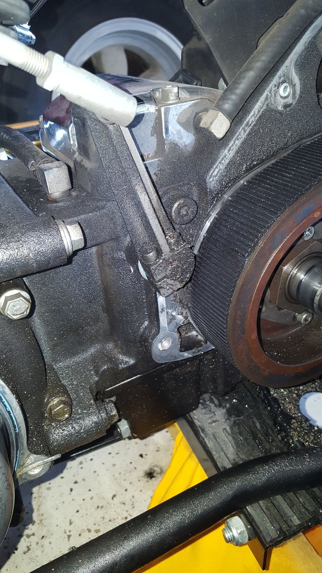

Looks like the Mainshaft seal was leaking..

Belts go 100k plus. Save your time and money and reuse the belt.
you don't need any of those tools unless u want to replace the seal that's in the main gear or change the primary bearing, also if u have impact to break the read loctite on big nut. Just have in gear with two by four in front of rear tire. The rag thing is for the clutch & comp nuts. The seal inside the gear looks ok & bearing.

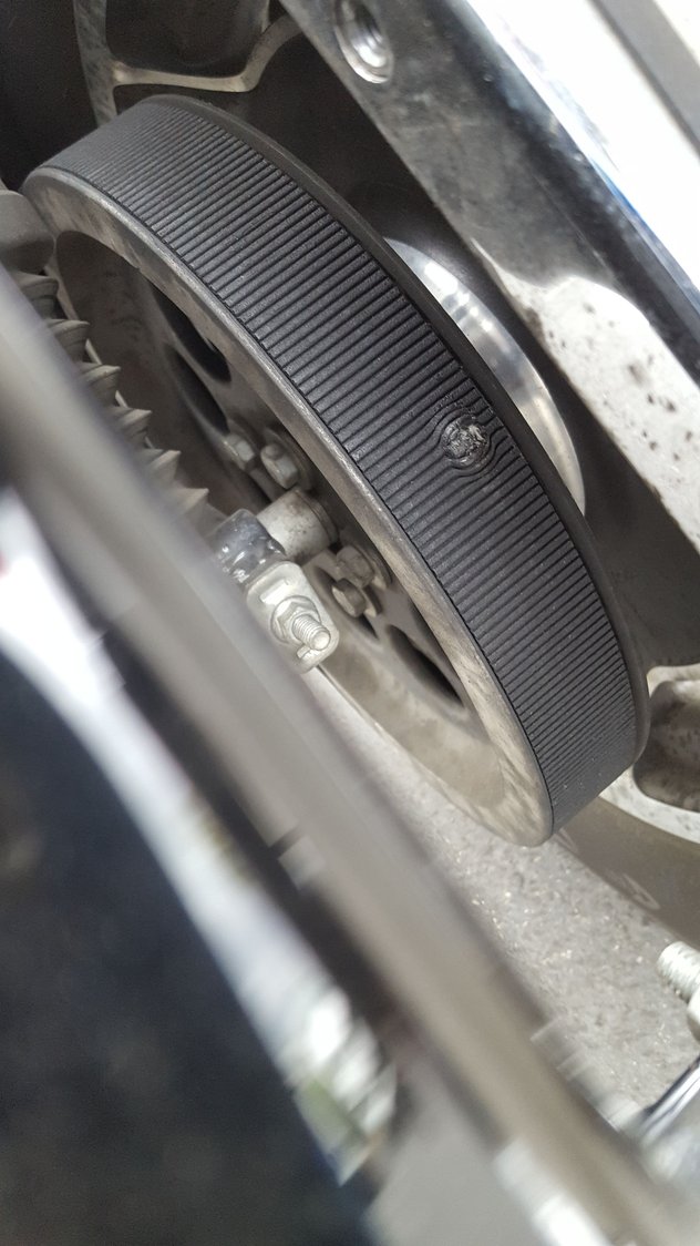

Have this rock in there... should I leave it alone ? It's been there for the past 20k.

Change the belt. This one had a rock hole in it for 20K miles also. They always seem to fail in the most remote locations. My buddies did 3,000 miles from home. Three days and a few thousand dollars later he was back on the road with a new belt and a rebuilt transmission.

looks like the race has walked inward causing your leak on the mainshaft......
You can tell by looking at the bearing and case?
