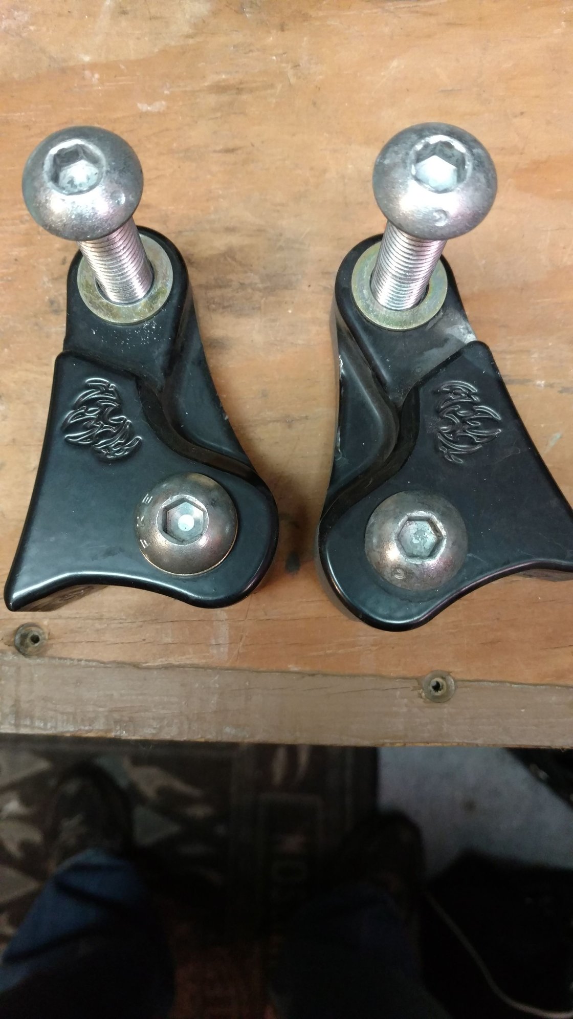

I had 13" air shocks on my RK. I bought some 12" SGS premium hand adjustable shocks, which is what you should have, and added these from Tamarrack. The only time I bottomed out was when I was 2 up and forgot to set the setting higher on the left side. I will sell you these for $50 shipped if you want. I bought a low CVO seat and took these off.
