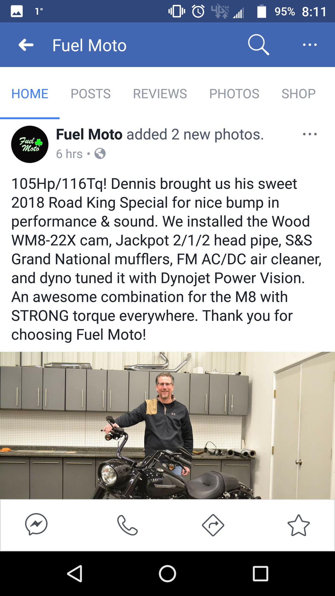

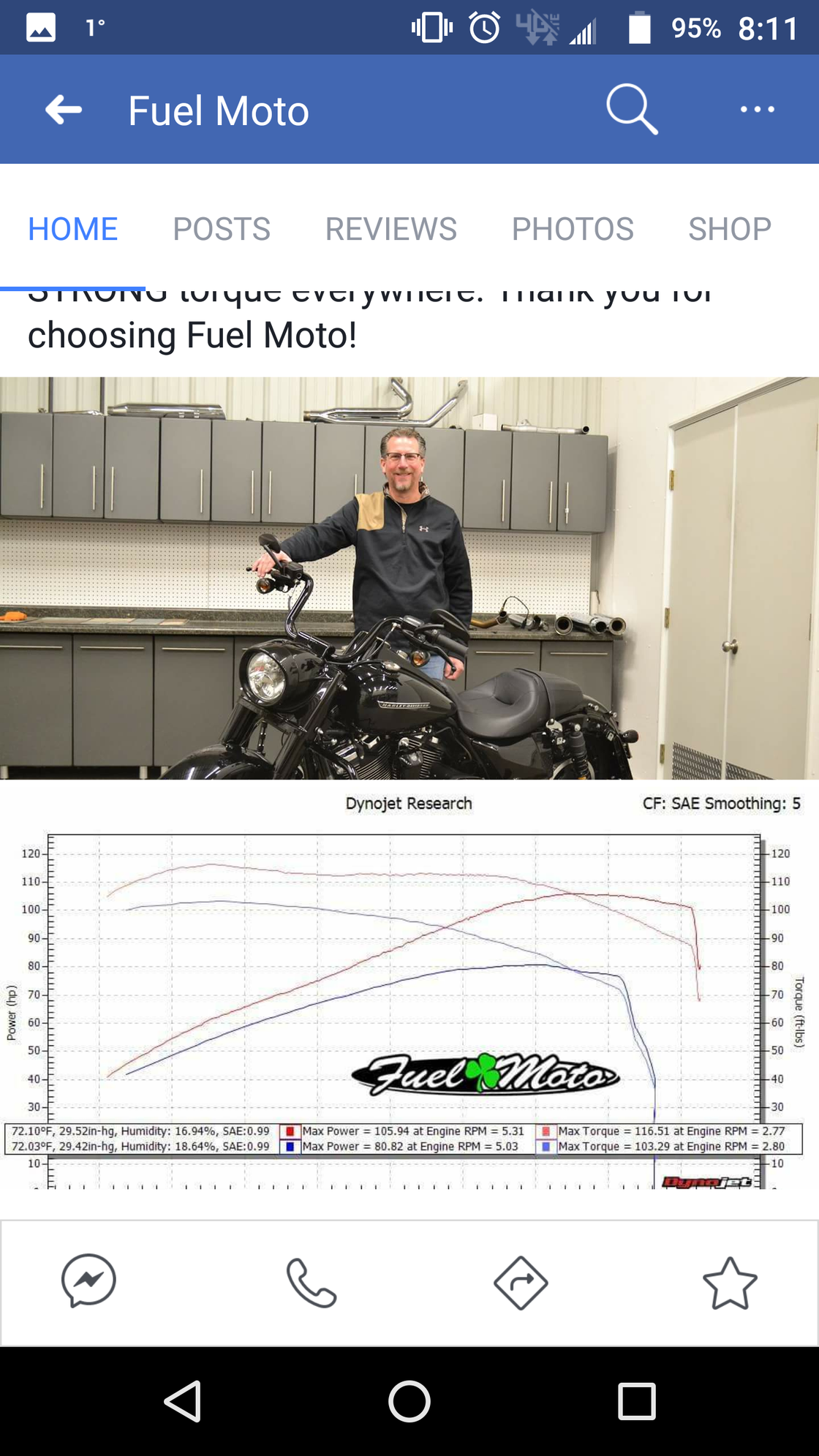

Old Feb 15, 2018 | 09:22 PM
  #1032
Dan D.'s Avatar
Dan D.
Joined: Aug 2017
Posts: 2,816
Likes: 1,718
From: Jacksonville, FL
Very cool... Nice improvement.
