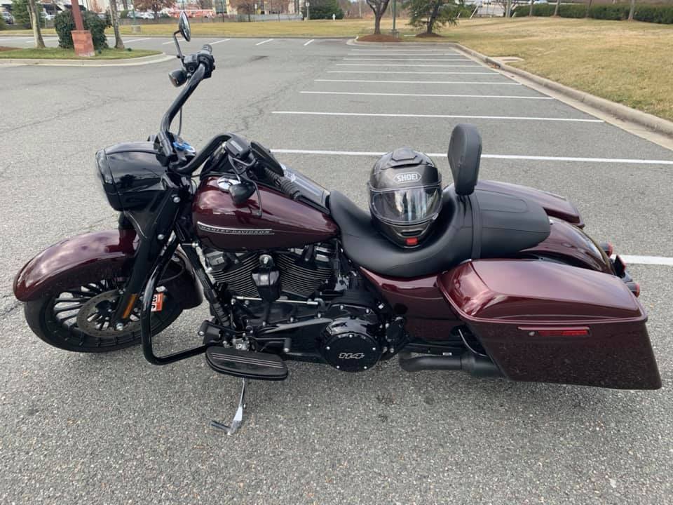

Just chilling here in Richmond Va. Looking forward to getting out some this weekend.

love that color and how well it goes with blacked out

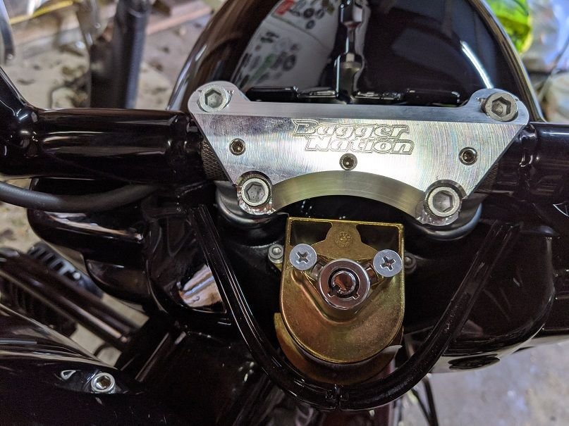

Do you have a picture of the top of the clamp? Or a link to the one you used?

I tried to use Yaffe's 1" riser for the Monkey Bars, but the OEM clamp cover wouldn't fit over it, so I went with the standard Road King risers (HD 57450-14 and 57451-14) which are shorter, and the Yaffe Super Clamp. http://baggernation.com/item.php?iid=75

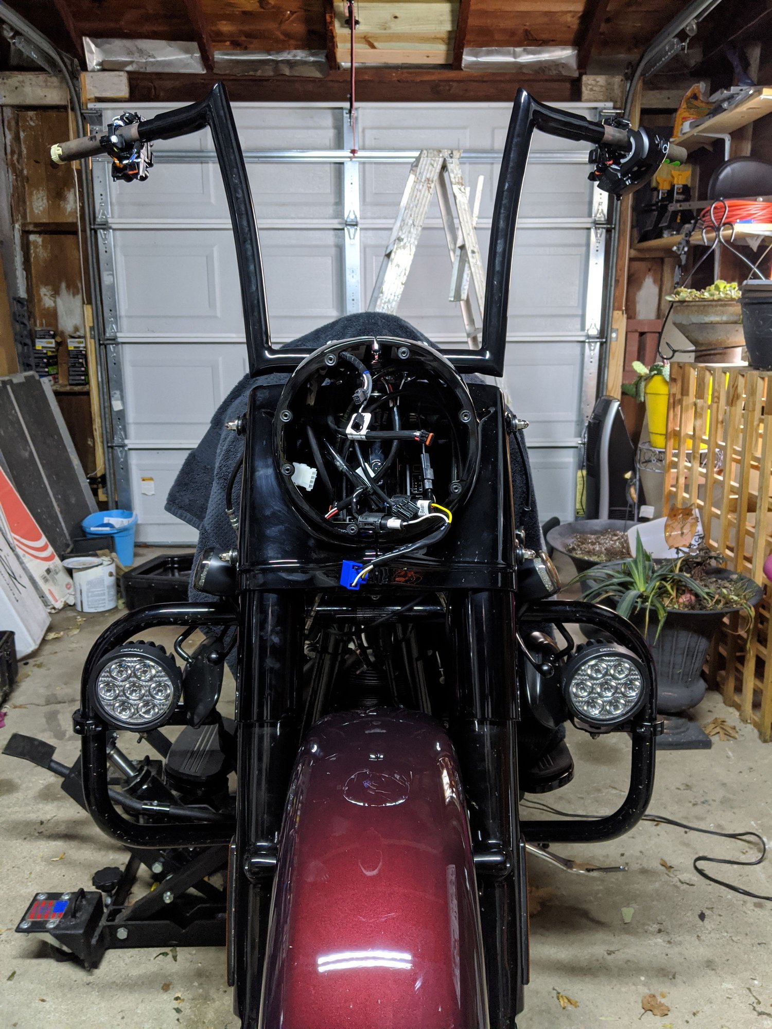

Does anyone know if this fairing will fit with the passing lamps installed on a RKS? I have attached a pic my my bike is you dont know what I am talking about. I email memphis shades and they said they have never tried.... whole lot of help.... and I cannot find it anyone on the net. Thanks

Are those factory lights? Doesn't look like it. You're being a little rough on MS - you can't expect them to try fitment with every single aftermarket part out there.
That said, those brackets look like they have the lights way further out then the factory kit, so looking at the fairing it looks like it would fit. You could always pick one up from somewhere with a liberal return policy (like J&P cycles) and try it out. If it doesn't fit, return it...
I was looking (and still am) at a painted fairing from Glide Pro, though much more expensive ($650) https://glide-pro.com/shop/cafe-fair...iring-painted/ they look really great.
