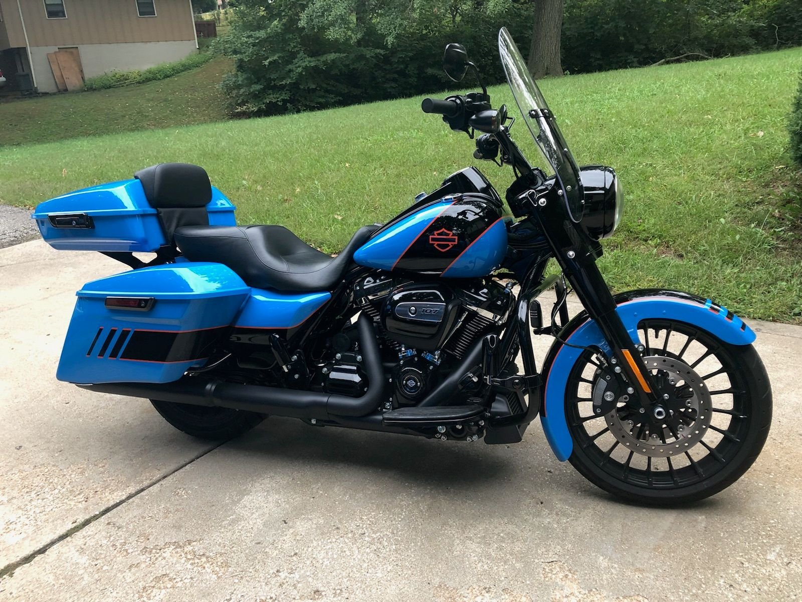

Default 2018 RKS with Factory Boss paint

Damn that’s pretty

Your bike looks really cool, but when i see the wrinkles in you back seat back-pad, im wondering what the company is doing to us for all the money we spend :-(

that's not the seat that came with the bike. friend of mine gave me that seat. the wife needed a more comfortable seat for the long rides

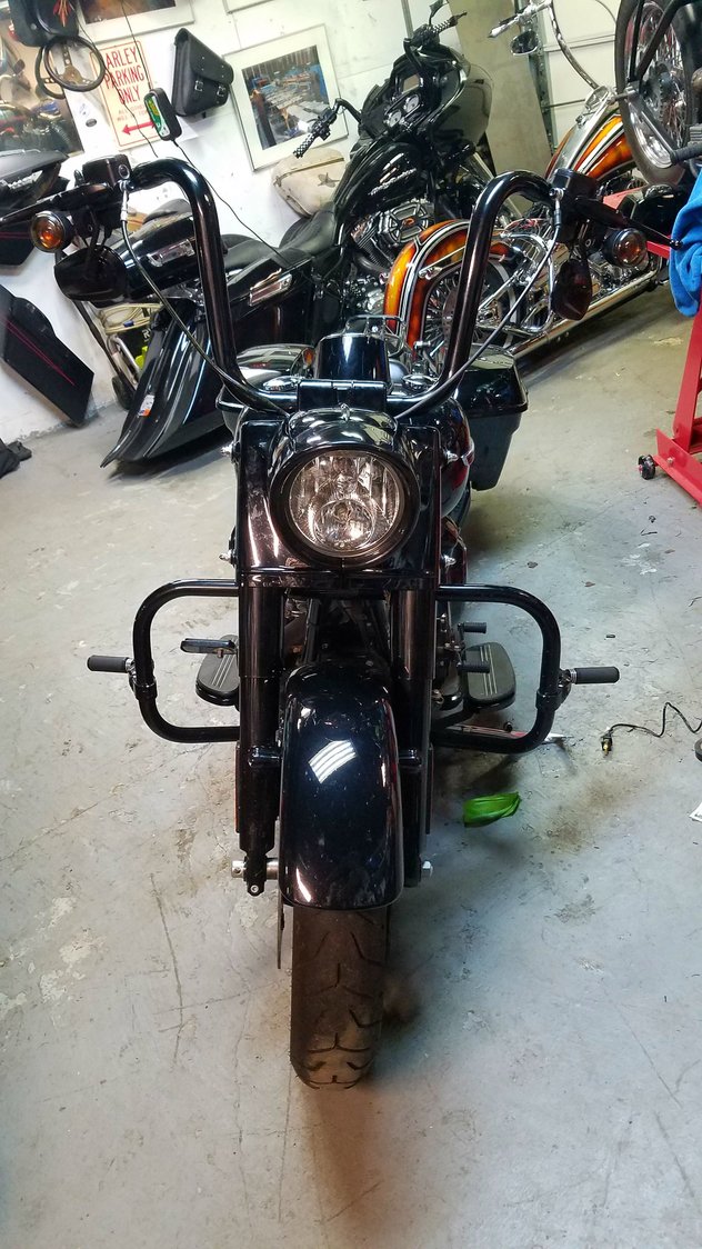

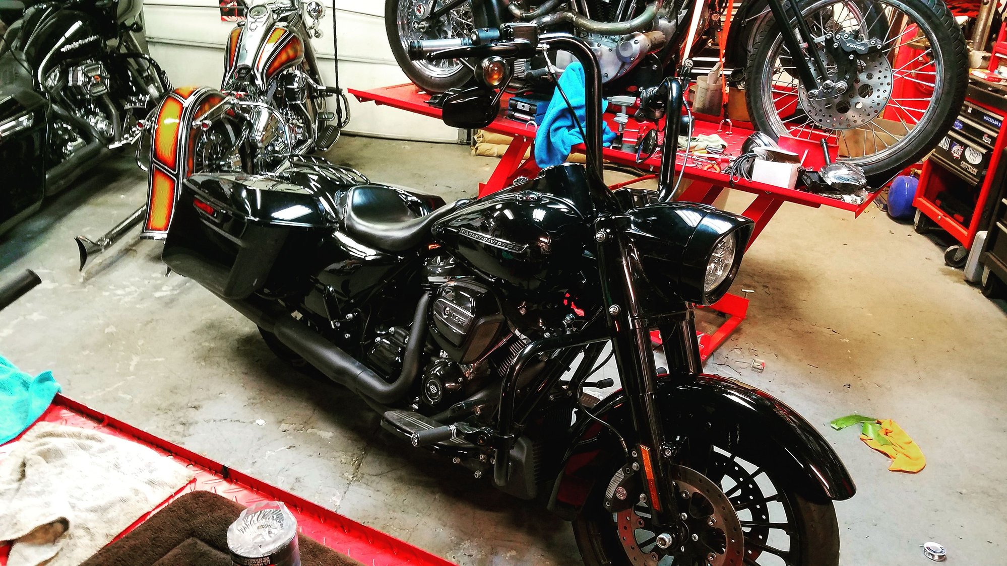

Got the new bars installed on the RKS last night. 13" rise, 9.5" pullback, 41" width, 1.5" diameter. Had to change the clamp because the bars are 1.5" at the clamp area, and extended all the wires, but stock cables worked after I pulled them out of the clip on the neck.
