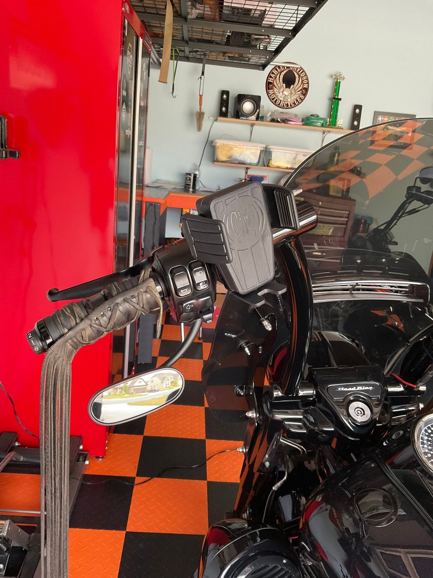

Installed Ciro phone holder/charger, wired up to accessory harness end that is ignition hot. Tested charging power with gps and music running and it charges the phone with those apps running.

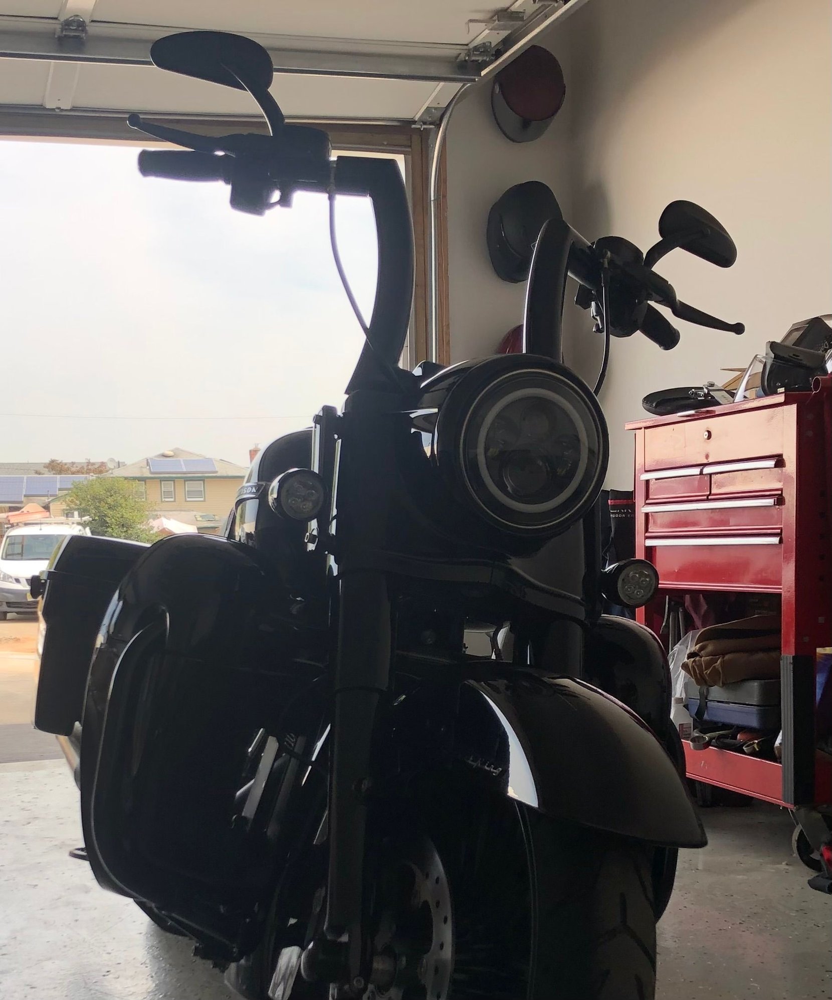

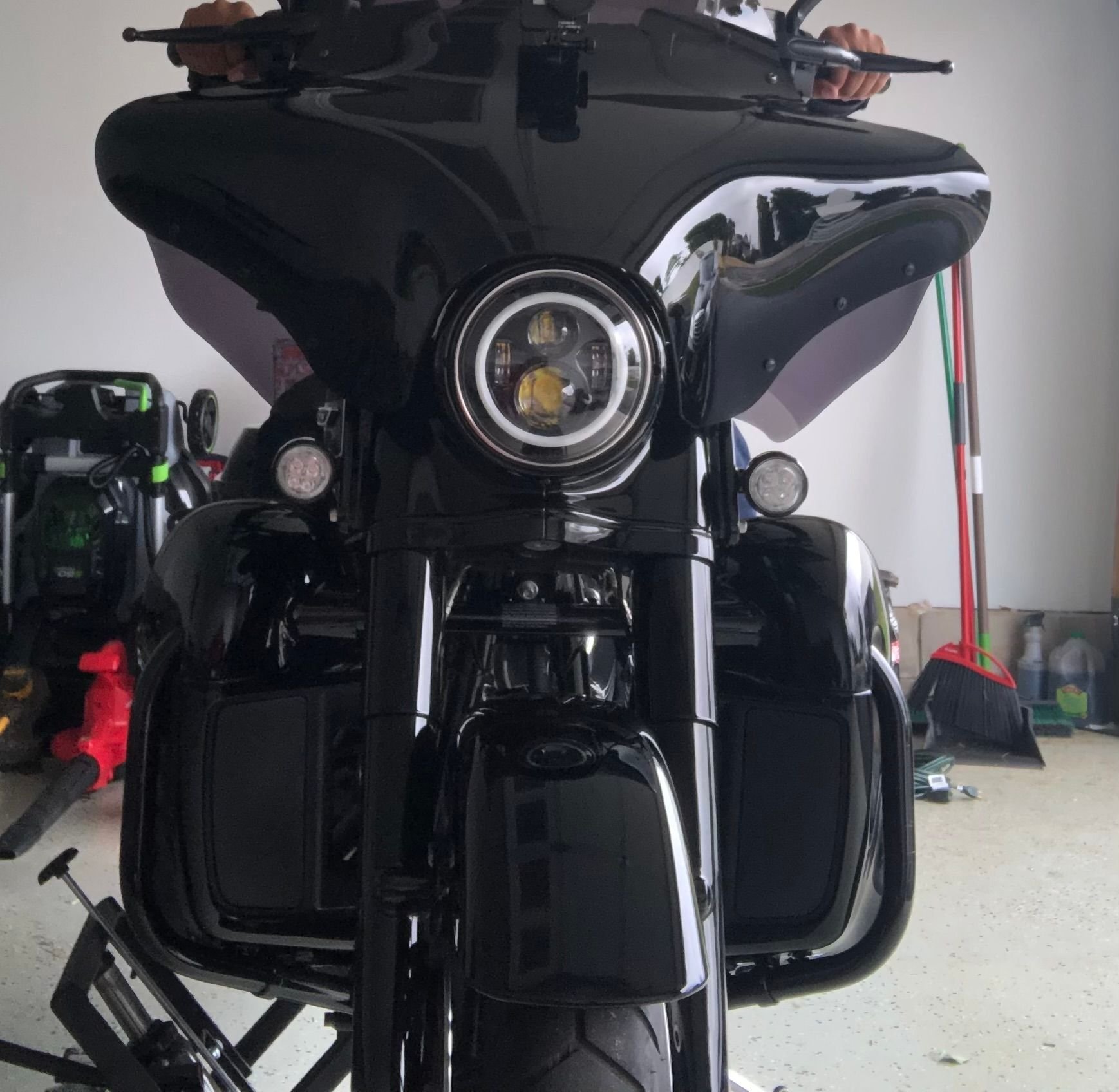

JLB2782: I have mounted a MS Road Warrior on my RKS with similar Harley brand turn signals. With this style turn signal/passing lamp (same style as the ones you are considering) you can run a Road Warrior fairing and a MS Batwing fairing. There's only one issue: The passing lamps of this style are meant to run flush to the side of the front forks. In order to run the MS fairings you have to also run the 4 rubber grommets that they need to latch on to (same as ones found on the Road King standard w/ windshield set up). Problem is that running them in between the passing lamp bracket and the side of the forks leaves a funky gap which is very visible when the fairing is removed (but not noticeable with the MS fairings on). Hope this helps. See pic of this set-up with fairing off (looks goofy). I used to unscrew the four bolts and remove the rubber grommets when not running the fairing just to see that bracket sitting flush like it should (minor PITA).

This is what CJ was talking about the gap.
