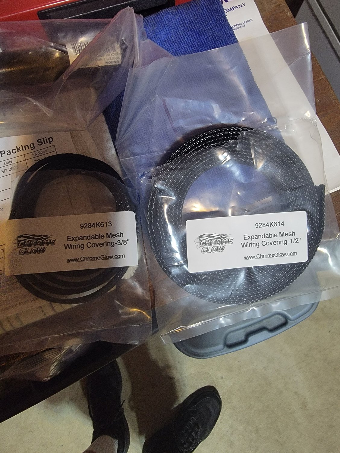

Yes sir I will definitely post some pics. I also bought some expandable mesh wire covering since the h-bar wires will be exposed in the middle of the risers going to the headlight nacelle. I want everything nice and tidy. I'm also having the kickstand powder coated at the same time. I gave up trying to find a black one from a vendor. Those things are like gold if you can find one.

Their risers do have slots for the wires to pass through from the bars but you can still see the wires going down to the headlight. I'm going to make it look like one single harness with the mesh covering vs the individual switch harnesses and throttle harness. The good thing about Kraus is they are modular in design so you can try different length riser bars and the poly urethane bushings are up in the h-bar clamp vs being at the triple tree end. Plus they are mounted on the tree with solid bushings. That's great to know about the pull back thanks for the info.

CJ these are the slots in the Kraus risers and the holes in the bars for wiring.
FM H-Bar
Expandable mesh wire covering.
