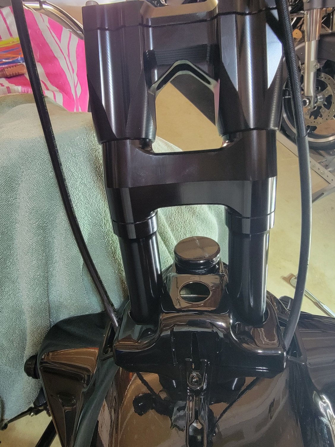

Well I just dropped off the second brand new HD chrome riser cover at the powder coater. The first cover warped under sand blasting and the subsequent heat from the oven during the PC process. This time they are going to hand sand it only then apply the gloss black coating and bake it. Still on hold from installing the Kraus risers. More to come.

Finally in the process of installing the Kraus 10" kickback risers and FM Motobar. The cover the risers are passing through was the powder coating nightmare I've been dealing with. It's done and installed.

Thanks CJ so far so good I will finish it today. I found out you have to start the right Kraus provided riser bolt first because they are alot longer than the stock bolts and you need the riser assy loose to work the right bolt in. Of course I found this out after I had installed the left bolt so I had to remove it lol. There's no instructions provided by Kraus but I told their Tech department this tid bit yesterday on the phone. They also don't tell you that you do away with the ground cable that's attached to the left stock riser. It's not needed on this setup. No one really knows why HD even has that ground on Road Kings since our ignition switch is console mounted.
Supposedly that ground is for the Street and Road Glides but I don't know that for sure. As far as hanging the controls I use those vinyl covered bycicle hooks folks use to hang a bike upside down.

I understand completely and as you know these Kraus risers are high dollar and I thought long and hard about pulling the trigger or going with a lower priced setup. I hope like hell I like them lol. I can't comment on the stock RKS bars but I hate the 14" apes the original owner had installed on my bike. I've been riding with them since May of 2021 when I got it. They had to go. Apes look cool but for slow speed riding and overall comfort they are not ideal.
