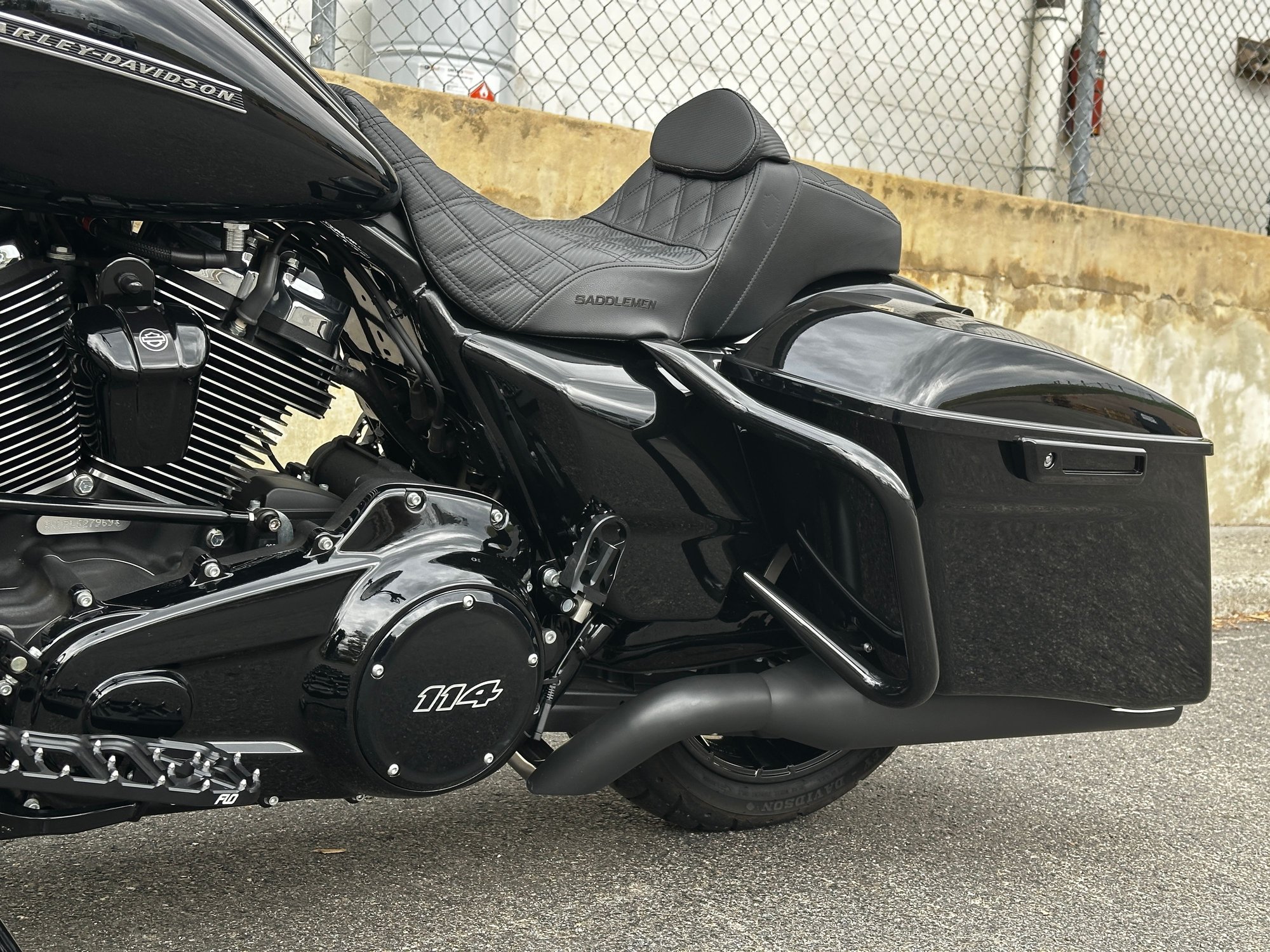

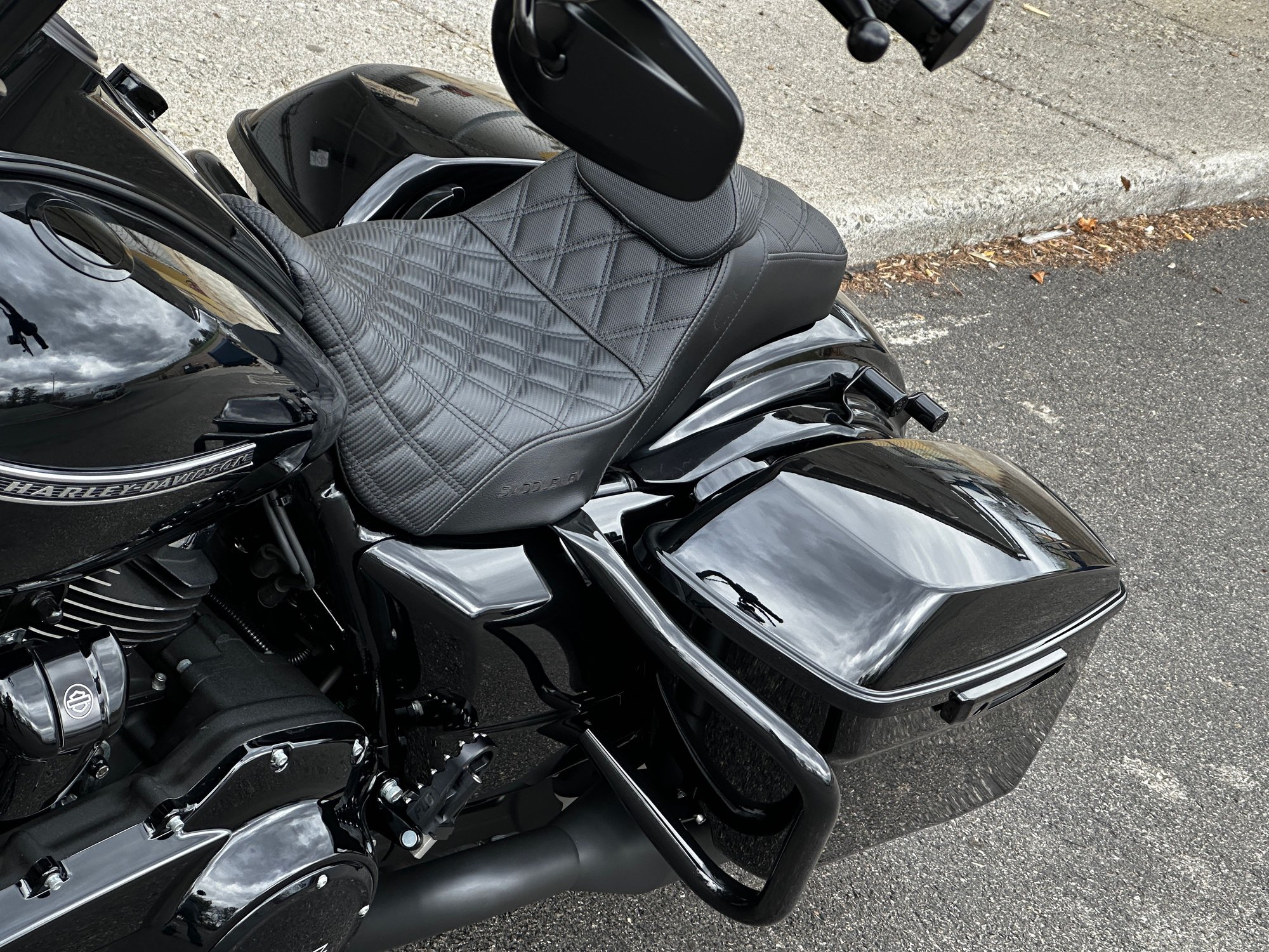

I went with the Hogworkz 1.25" bag guards. They were like $250 I think. Well worth the piece of mind. Those stunt bike bag guards are a bit more pricey I believe.

Good job, your saddlebag guards look mean..
What are your thoughts about the Step-up? Is it the standard reach model, does it bring you closer to the tank, and is the lumbar support good ?

I have looked hard at these a few times. Crazy question, but by any chance have you "tested" them? Either unintentionally or like on purpose with a rug or a few towels? I've always wondered if they protect the stretched bags.

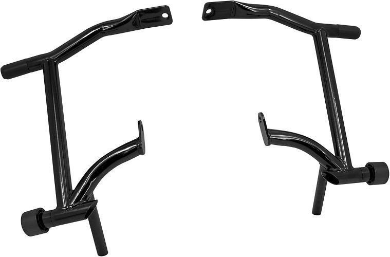

My Road King had nothing from the factory. I put the below bars on it and they have never touched when the floorboard scrapes. But, when I hit a slick spot in the rain, the lower wheel touched and turned to keep the bike from digging in and the bags never touched the ground.
P. S. The wheel will get torn up a bit when it saves the bike n bags. Small price to pay for them doing the protection job.
I've been doing a bunch of research on these bars, check you swing arms and your brake line on the right side. Seems like there is a design flaw with many of these where the lower mount is not shaped proper and allows the crash bar to hit the lower swing arm and damage the break line, all depending on the suspension travel. Many had to loosen the break line and move it inward, then add a 1/4" or 1/2" washer to move the mounting bar point away to help clear the swing arm top. This is not just for no name Amazon/eBay bars, it covers some of he more expensive brand names.
