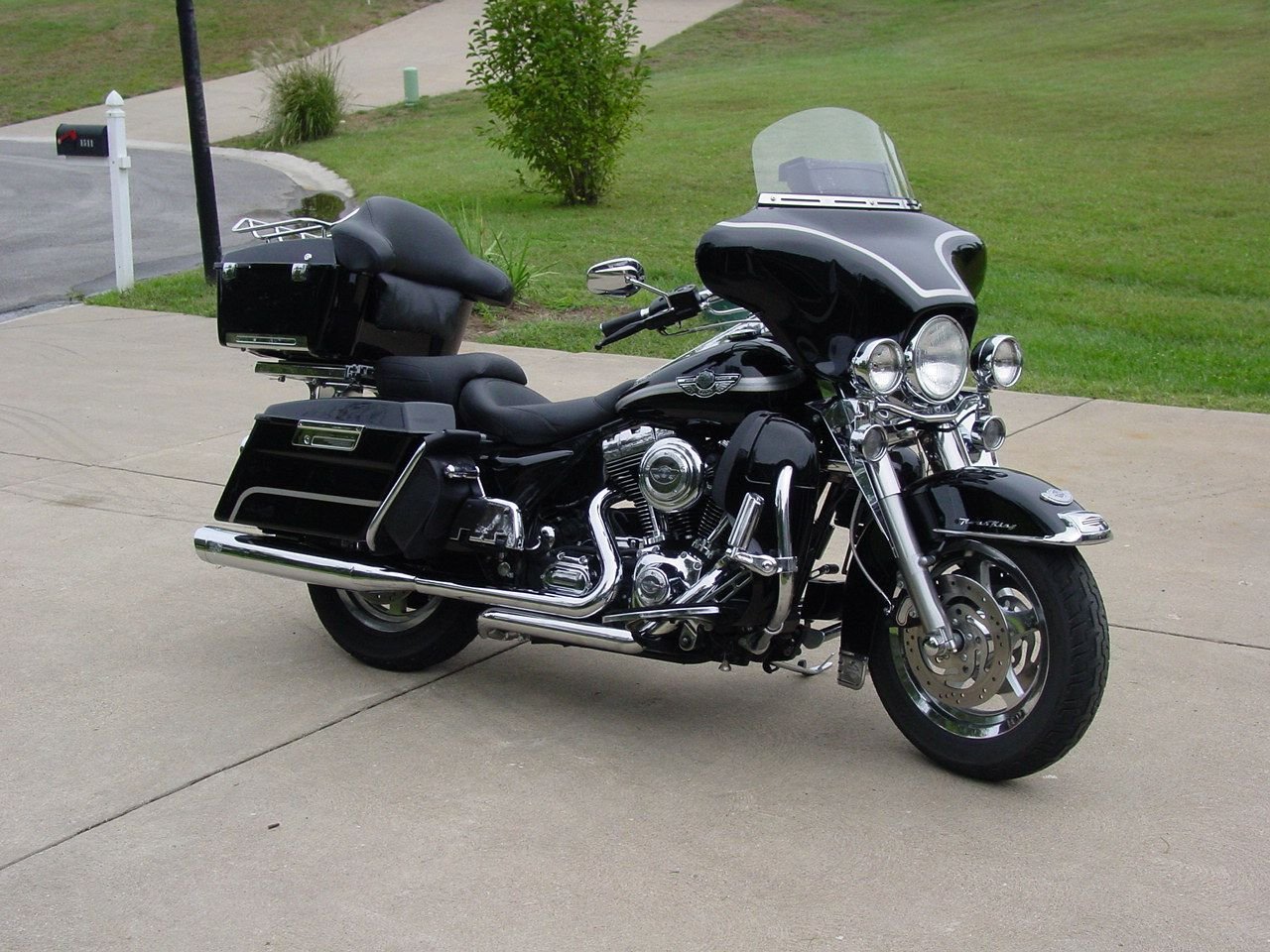

Our 2003 RK EFI had buffeting issues when first bought, considered as normal as riding as every other ride I had except the rice burners were open air no shields.
I started with the triple tree baffle made some difference, with the shield aged and scratched added a longer shield, made it worse again. Invested in the fork side shields again much better where I bit the bullet and went to a detachable fairing from Dead Center and factory lowers. Looked like a Ultra from a short distance behaved as a Street Glide but most of the issues were eliminated except the buffet steer from large machines on the slab as RVs and semi's.
Did not have engine heating issues with a 88 on a Stage II with a add on fuel management system. Oil temp gauge on dipstick would range to 245 continually originally equipped stayed down around 230 with all the shields in place. Dead of summer or center of KS at 108 highest I ever saw with shields on was 240.
Only significant heat around us was the cross over exhaust that received less down air, that I fixed with under mount dual exhaust.
Could not manage the twitch around big boxy machines so went RGU, never happier.
